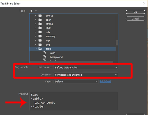

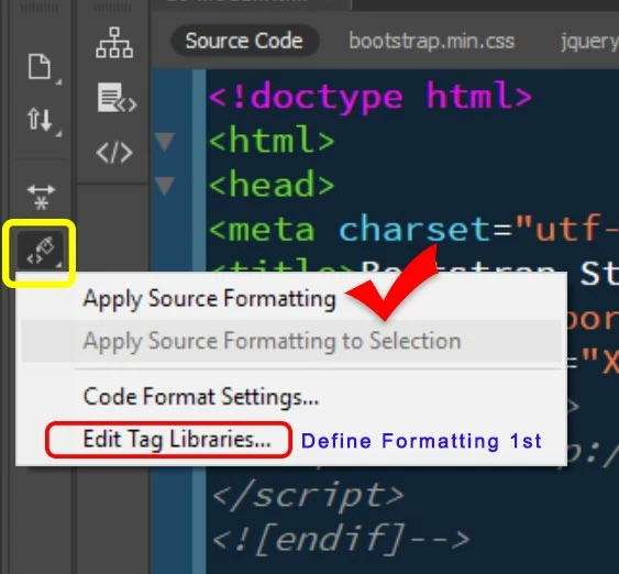

Go to Edit Tag Library to set up your code formatting rules.  You can reach it from the Apply Source Formatting tool.  See screenshots.

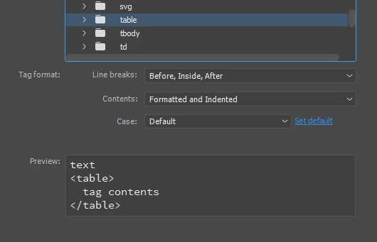

Thanks for the reply, but I already had that set, and I am still not getting the extra line and indenting between the tag. When I close the opening tag, it creates the closing tag with the cursor between the tags, but when I press enter, it just moves the closing tag down to the next line without creating and indenting the next line. See the screenshots below.
