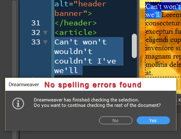

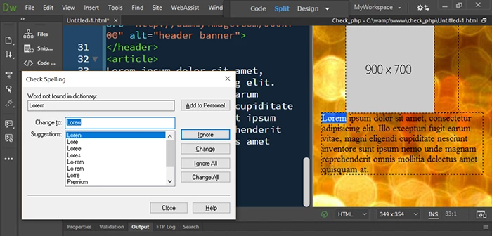

    Jan 28, 2017 8:22 PM UTC
    #4 Spell check window defaults to the left side.  My custom Workspace is set up with code on the left and design on the right.  So it's no hardship for me.
    I know of no way to change the default.  Feel free to submit a feature request.
    Nancy
    Nancy OShea
    Jan 28, 2017 8:11 PM UTC
    #3 I can't reproduce this.  Spell check with contractions works fine for me in CC 2017.1 on Win10.
    Nancy

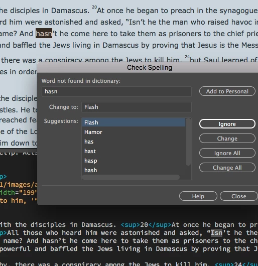

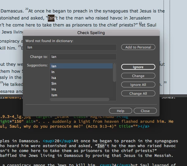

    Nancy, hello, again:
    Since you responded to my concern regarding DW CC's inability to accept contractions when I check spelling, by telling me that you haven't experienced such situations with Windows-platform machinery, I've since created a new page on a different site and the spell-check feature again flags standard contractions on my MacBook Pro.
    Might this be a platform-specific issue?
    Here are two screen shots of the problems flagged from the same paragraph on the same page. I copied/pasted the text from an third-party website. Might that be the problem?
    Wondering Warren
    Jon Fritz
    Feb 7, 2017 2:12 PM UTC
    The spell checker is having problems with your use of curly quotes in the text block.
    When pasting text from another program, make sure to use the Paste Special option (Ctrl + Shift + V) and check the box for "Convert smart quotes to straight quotes".
    Once the curly quotes are changed to straight, the spell checker will see contractions correctly.

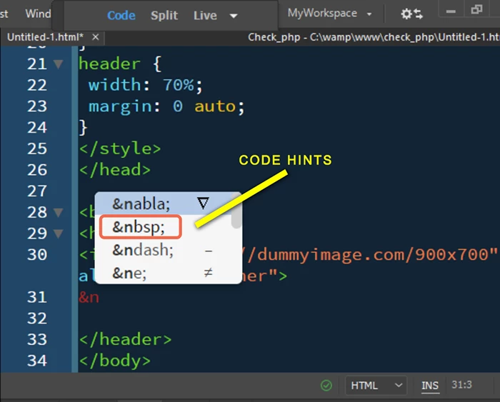

    Jan 28, 2017 7:35 PM UTC
    #2 Type &n and code hints window should pop-up.
    Alternatively, you could create a code Snippet and target key.
    Thereafter, type your target key followed by TAB.
    Nancy

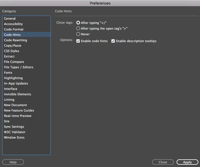

    Jan 28, 2017 7:21 PM UTC
    Hello, Rob:
    I reviewed the linked thread. I'm afraid that I don't see the relevance of that thread. Further, I'm a Mac user and cannot follow the directions given in those posts.
    If it helps, I'll attach a screen shot of my Code Hints preferences window. In it you'll see that I've only made one selection.
    Might you have a follow-up suggestion to make? Thanks, Rob.
