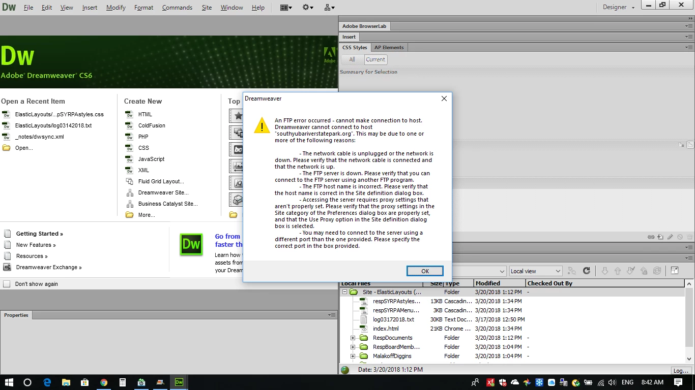

Below is the screen shot of the error I get when I try to connect to the FTP server. When I first installed dreamweaver I was able to connect and transfer all the files I needed to my computer. After that I have never successfully connected again. There is also a webpage on this server that I can no longer access. However, I can access it outside of my network at a neighbors house. I have worked for about 2 weeks with support from the router company and we made a fair amount of changes and still nothing. I am doing volunteer work and trying to maintain a website. Any suggestions are welcomed I am frustrated.

If you can access the server at a neighbors house but not your own, then I think we can safely rule out DW as the cause of the issue.  Next time you go into DW, click on Site->Advanced->FTP Log and try to log in via FTP again.  Let us know the error that is being returned in the log.

I tried this and it still does not work.  Nothing appears in the log. The thing that really troubles me is that after these issues starting happening I can no longer access the website from home.
