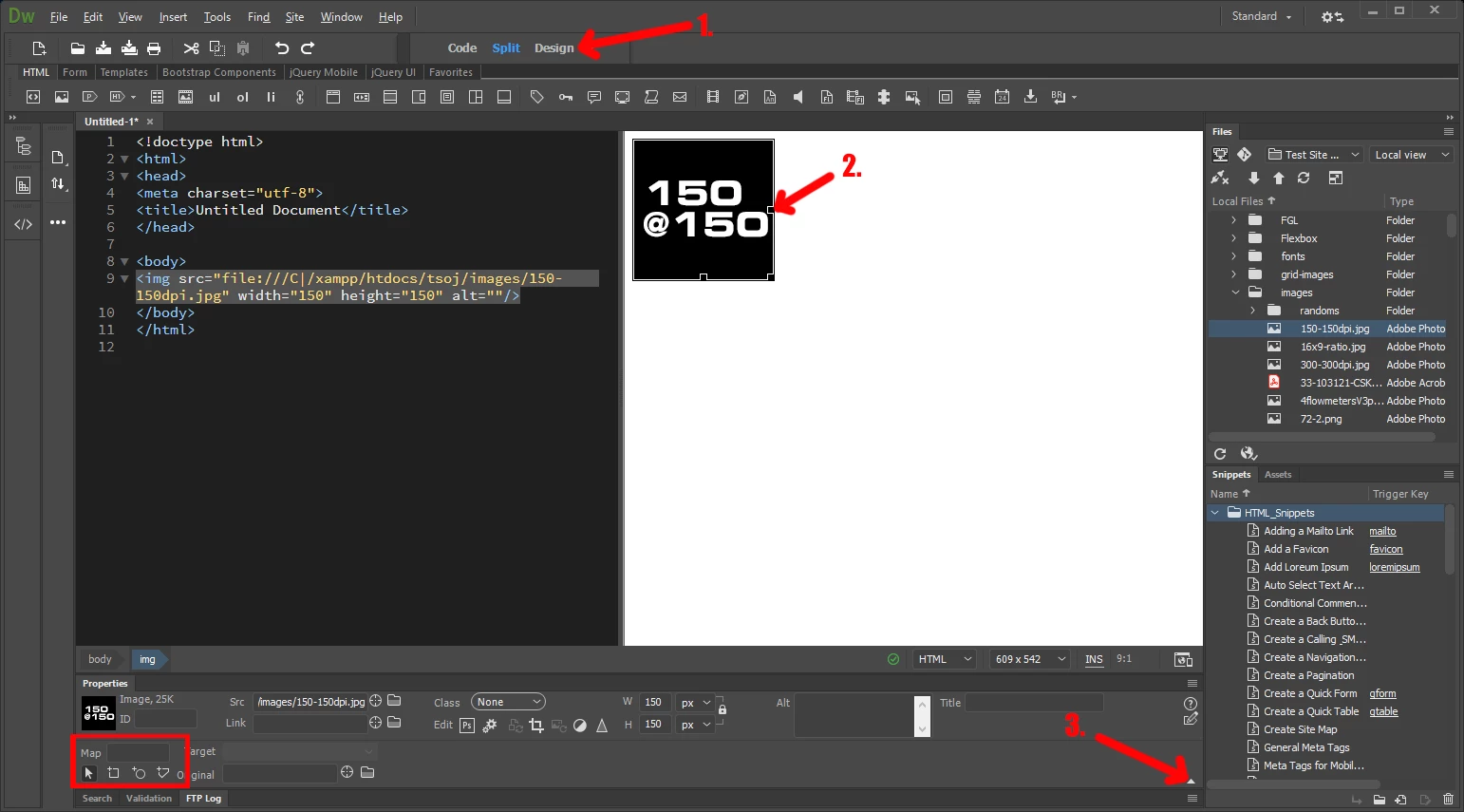

Things to check...
1. Are you in Design View?
You will not see the Image Map tools in the Properties window while in Live View.
2. Is the image selected?
The Image Map Tools are not available until the image is selected.
3. Is your Properties window expanded?
There is a tiny triangle on the right side of the Properties window, that needs to be pointing up to fully expand the window and expose the Image Map tools.
