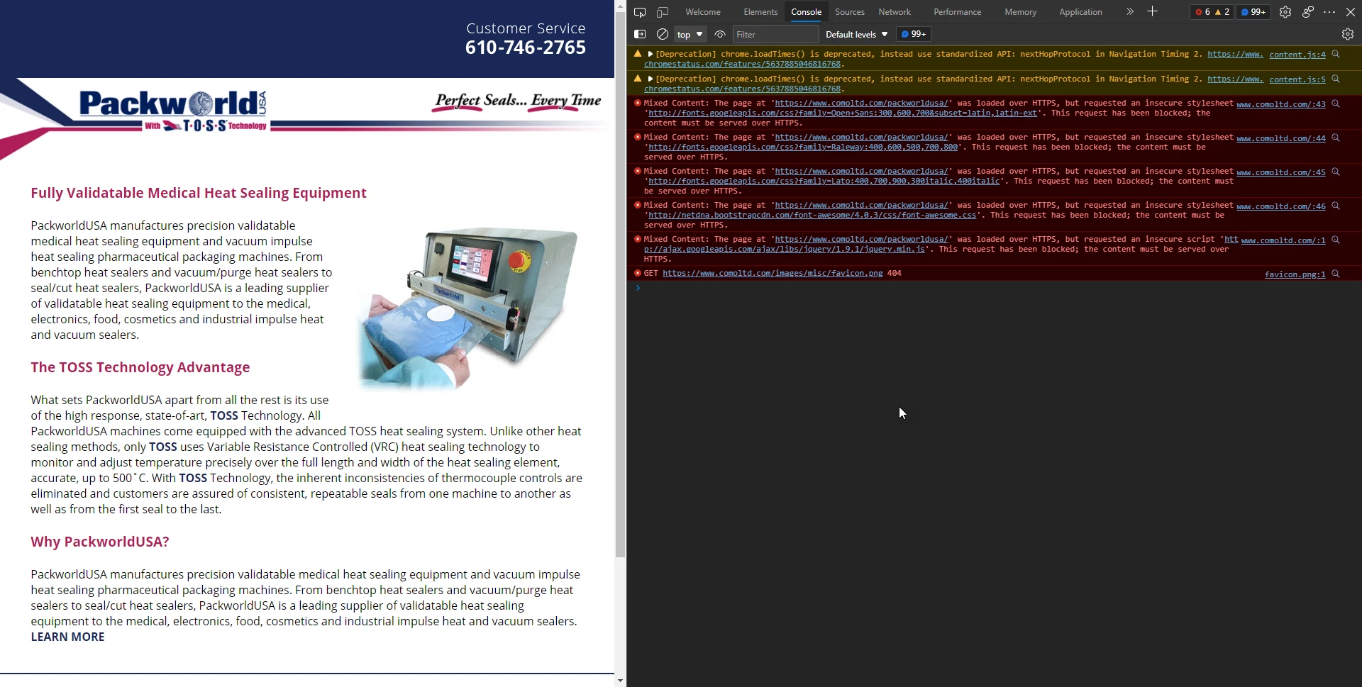

    BenPleysier
    Oct 14, 2021 4:31 AM UTC
    This may not be a solution to the problem, but it is a good idea to fix thse problems first:
    In case you cannot read it, the problems are links to HTTP instead of HTTPS.
