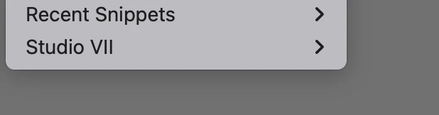

    Does anyone remember the fix for, PVII extensions are installed, yet when I select "Insert", Studio VII  is there,, but no extensions appear. I recall this happening years ago after a Dreamweaver update, but can't remember the steps to fix. Thank you!
    Aug 21, 2025 6:26 PM UTC
    The extensions still work for me, using the latest update of Dreamweaver.
