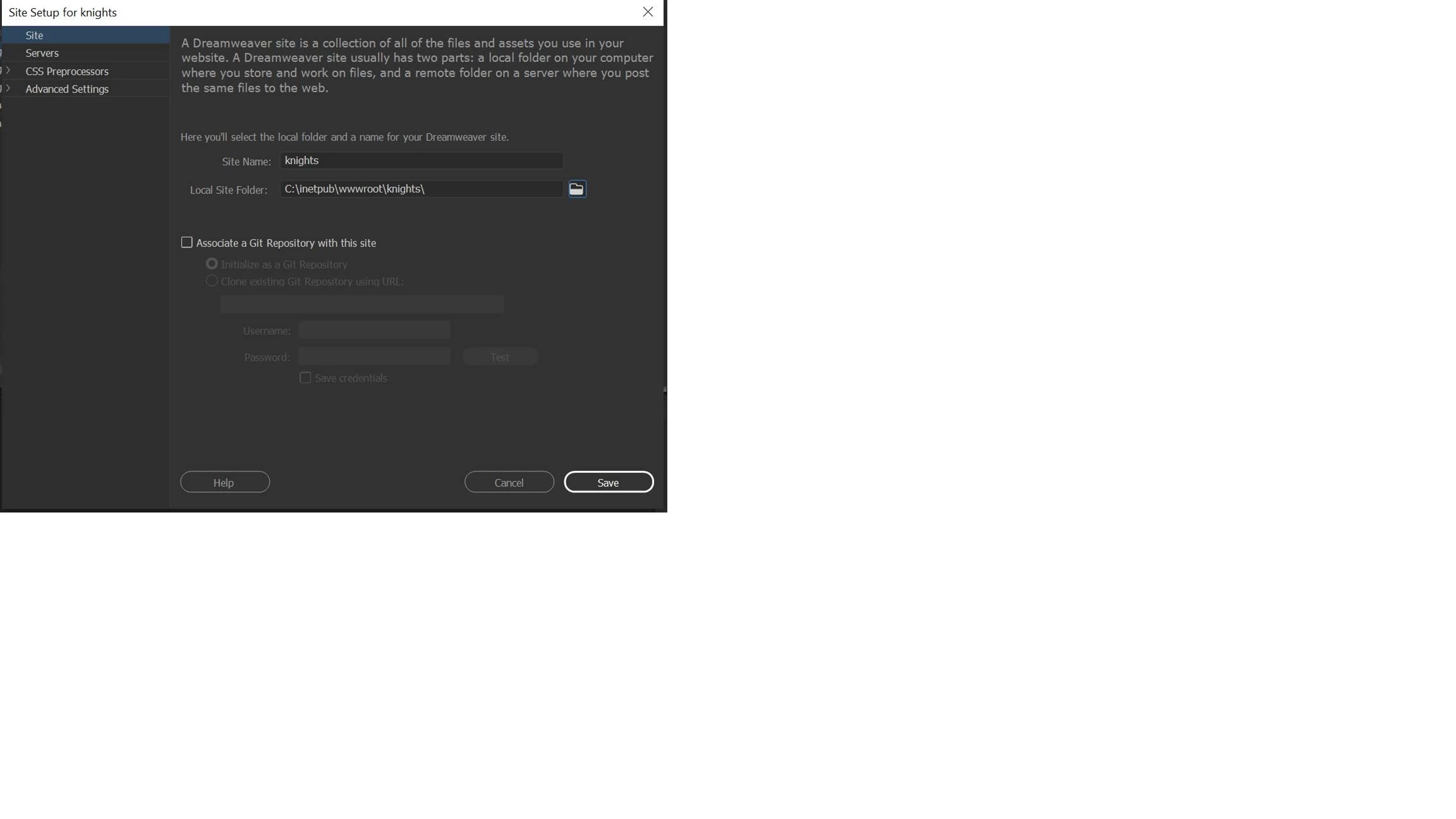

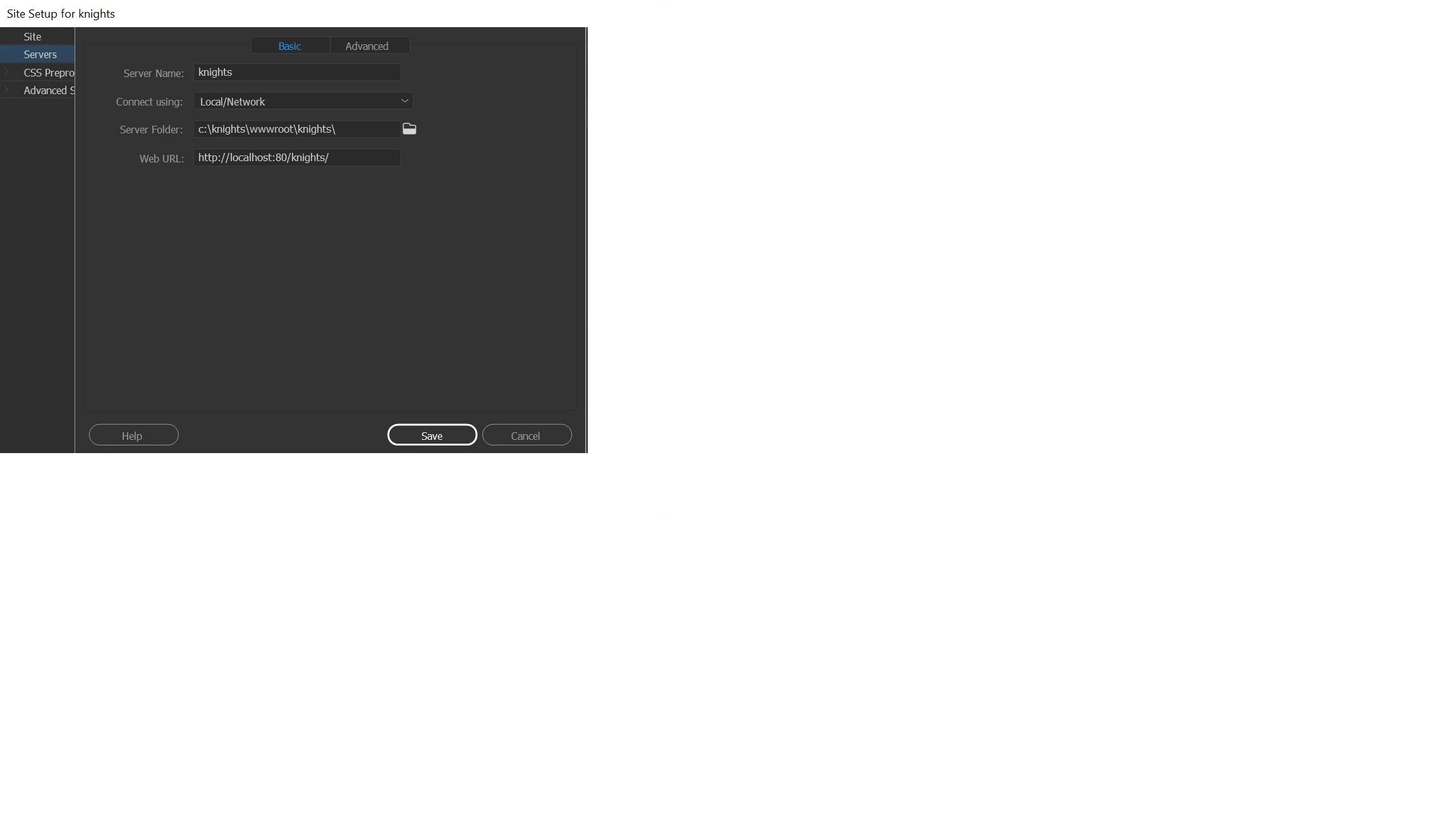

    Let me try to give you my setup. My localhost is knights. My site name is also knights, The default web folder is in c:\inetpub\wwwroot\knights.
    So looking at the Site Setup folder
    After clicking the Select button the error occurs.
    I have also installed the DMXZone Extension Manager and have installed the Server Connect Version 1.8.6. After opening the DW product I do not see the product installed. I wen under Window- Extension and see no product installed. Should I see the product there?
    Any help you can provide would certainly be appreciated.

    BenPleysier
    Apr 11, 2020 12:06 AM UTC
    The MySQL server is localhost, no more, The Database field should contain the name of the database.

    Apr 9, 2020 10:22 PM UTC
    See screeenshots for setting up a local testing server in DW.
    In my example, I'm using Wamp server.  And my default web folder is www.  On Xampp or Mamp Pro, you will use htdocs instead.
    Keep in mind that the old MySQL connection scripts (mmServerScript) will not work on servers running PHP 7 or higher.  For these and other reasons, you would do well to replace deprecated server behaviors with a commercial extension from WebAssist or DMX Zone.  Or write your own code in PDO or MySQLi (improved).
