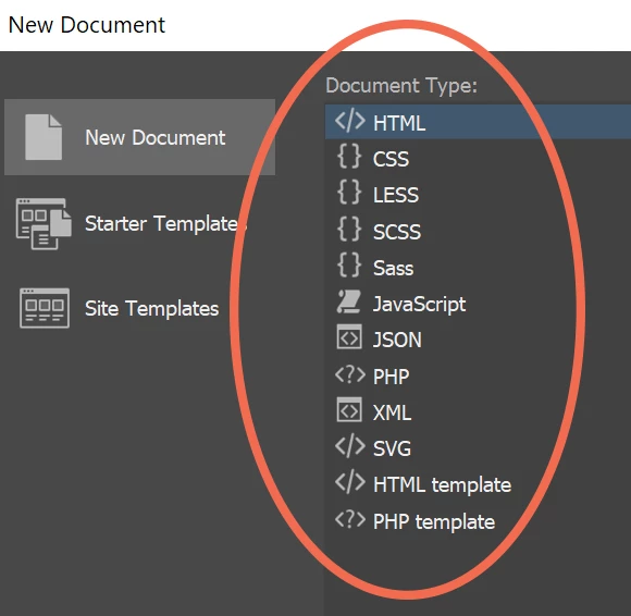

JAVA  isn't as popular for web programming as it once was.  These days, DW doesn't support it.
