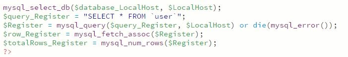

Help with the error Deprecated: mysql_pconnect(): The mysql extension is deprecated and will be removed in the future: use mysqli or PDO instead
How do I change this code to the extension msqli or pdo so that the error goes away?
Rob Hecker2
Rob Hecker2Correct answer
Apr 20, 2017 12:06 AM UTC
Ebay is correct.
The following would work:
try {
$dbd = new PDO($db, $user, $pw, array(PDO::MYSQL_ATTR_INIT_COMMAND => "SET NAMES utf8"));
$dbd->setAttribute(PDO::ATTR_ERRMODE, PDO::ERRMODE_SILENT);
catch (PDOException $e) {
     die('Connection failed: ');

MySQL test connection:
<?php
$conn = new mysqli('localhost' , 'username' , 'password' , 'database_name');
echo "<h1>Success in database connection! Happy Coding!</h1>";
// if no success the script would have died before this success message
Apr 19, 2017 10:01 PM UTC
Actually, without an explicit die argument the script will not die. The success message will still appear on the page. An access denied warning message will appear if the script is unable to connect to the database.
