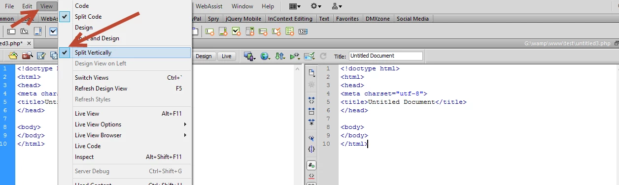

BenPleysier
May 10, 2013 1:23 PM UTC
Remove the tick in the following

Jon Fritz
May 10, 2013 1:22 PM UTC
There should be three buttons in your toolbar, Code, Split and Design.
Split should give you what you're looking for, or do you mean the Split View is vertical frames instead of horizontal?

Jon Fritz
May 10, 2013 1:31 PM UTC
It's in the View menu as Ben shows above. You uncheck the Split Vertically option.
