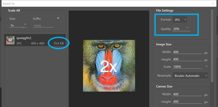

    Layering images on the web is not a good practice.  As Jon said, make your layered image in Photoshop and then use File > Export > ExportAs > JPG or PNG with transparency.   Make sure to lower the quality slider to reduce file size and save bandwidth.  See screenshot.
