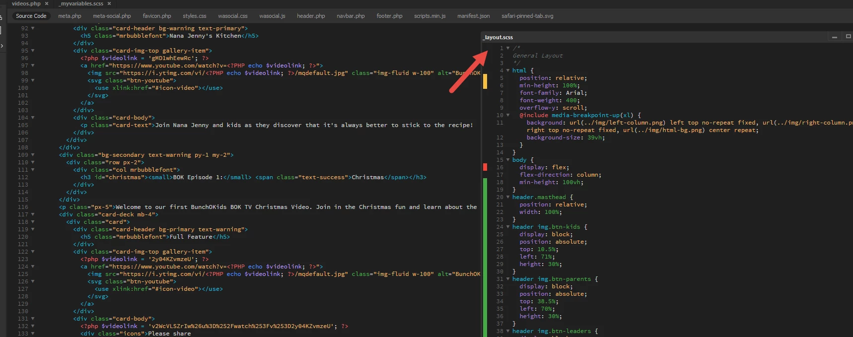

How do you split view two different files?
I managed to splitview the same code, for the love of me I can't find a way to view two different codes in each of the pane. While we are at it, is there a method to simply drag and drop files to create multiple views?
Thank you

Grab the tag of the second file and drag it away form the tab area

Ok I managed to do a horizontal split when DW is in windowed mode. As a a very small target area appears at the bottom where you drag a file into that area to split. I hope there is some better method to it.
