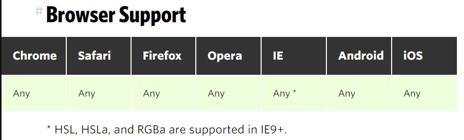

    Agreed, check caniuse: http://caniuse.com/#search=css3%20colors
    I'd say that with 97.88% global support you'd be fine. If you REALLY need to, provide a fallback for IE like so:
    background-color: #020202; /* rgb() with background-color fails in IE6&7 */
    background-color rgba(f2,f2,f2,0.8);
    Or something similar. But I would suggest to just stick with rgba only nowadays - unless your client requires stone-age IE support.
