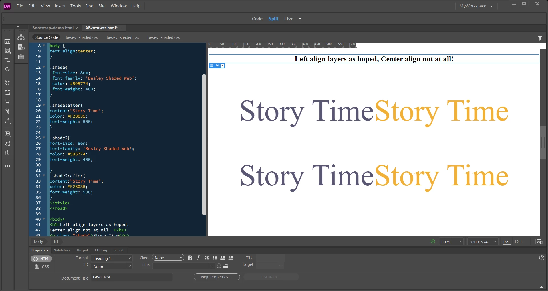

    Oct 21, 2024 7:11 PM UTC
    body {text-align:center;}
    Positioning removes elements from the normal document flow and should not be used in primary layouts.
    The same code without positioning results in text-aligned center as shown.
    PS. Obviously, I don't have access to your custom font.

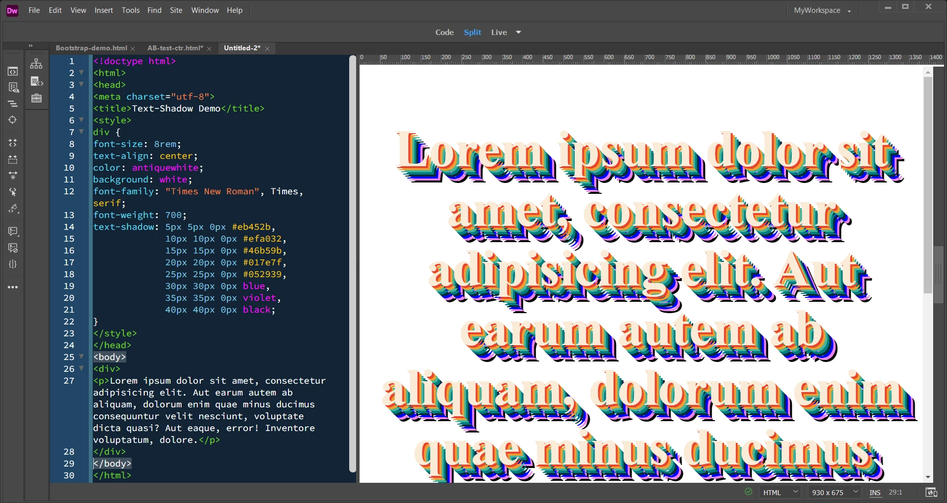

    Nancy OShea
    Oct 21, 2024 7:27 PM UTC
    Alternate approach with CSS Text-Shadows:
    <!doctype html>
    <html>
    <head>
    <meta charset="utf-8">
    <title>Text-Shadow Demo</title>
    <style>
    div {
    font-size: 8rem;
    text-align: center;
    color: antiquewhite;
    background: white;
    font-family: "Times New Roman", Times, serif;
    font-weight: 700;
    text-shadow: 5px 5px 0px #eb452b,
                 10px 10px 0px #efa032,
                 15px 15px 0px #46b59b,
                 20px 20px 0px #017e7f,
                 25px 25px 0px #052939,
                 30px 30px 0px blue,
                 35px 35px 0px violet,
                 40px 40px 0px black;
    </style>
    </head>
    <body>
    <div>
    <p>Lorem ipsum dolor sit amet, consectetur adipisicing elit. Aut earum autem ab aliquam, dolorum enim quae minus ducimus consequuntur velit nesciunt, voluptate dicta quasi? Aut eaque, error! Inventore voluptatum, dolore.</p>
    </div>
    </body>
    </html>
    Have fun!
