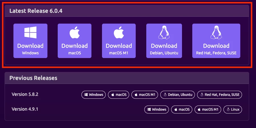

I still dont know which file i need to download and install if i want to work with Wappler. Thank you for your reply
Teodor K
Dec 20, 2023 8:48 AM UTC
Hi there, Teodor from Wappler here. Someone at our community mentioned you need help downloading Wappler. You just need to log into your account at: https://account5.wappler.io and go to the download section. Just download the version suitable for your OS.
Also, you can get help with Wappler in our community: https://community.wappler.io/
