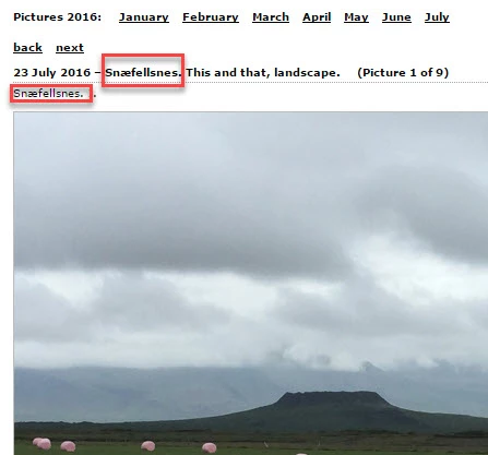

    An example:
    Claus in Iceland - 23 July 2016 - Snæfellsnes. This and that, landscape.
    Oh, it should be æ and not this "A:". Also on the website should appear
    23 July 2016 – Snæfellsnes. This and that, landscape.     (Picture 1 of 9)
    Snæfellsnes. I.
    above the picture.

    I've just taken a look at your website. Snæfellsnes is displayed correctly:
    If you're seeing SnĦfellsness, it means that there's an encoding conflict. UTF-8 characters are being rendered as ISO-8859-1 (Western European). All browsers now support UTF-8, so there's no reason to be using Western European as your encoding.
