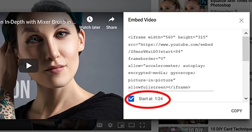

Upload video to YouTube.  Click the Share link,  get the embed code and indicate at which point you want the video to start.  See screenshot.  In this example, the embedded video starts at 1:24 from the beginning.
