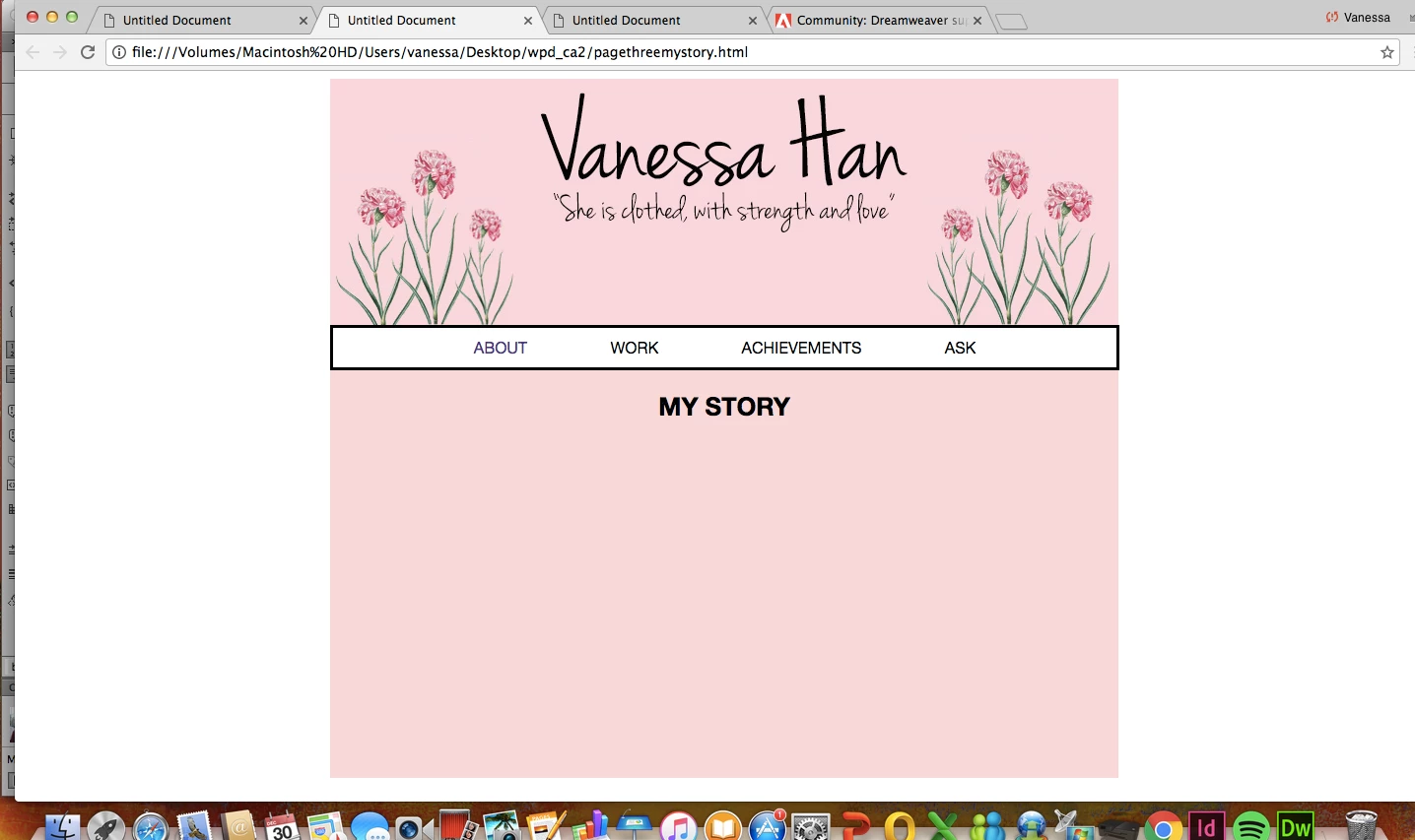

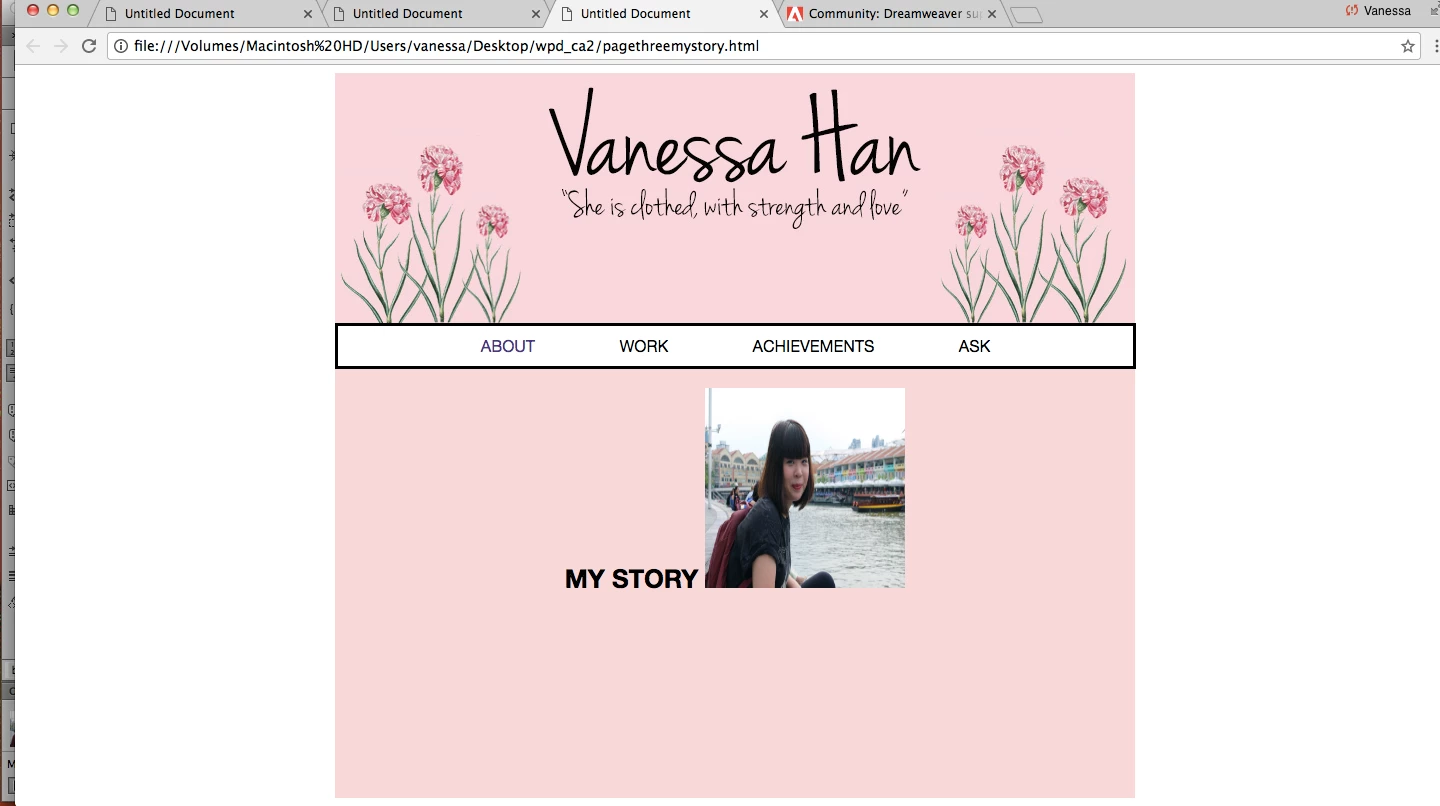

So before adding an image, the header was situated properly and normally. But after I added in the image, the arrangement became weird. Is there something I did wrong?
Also, the main part it automatically extended the height on its own. (compare the length of the main part to the first pic's main part. Its longer now? But i want it to stay the same size)

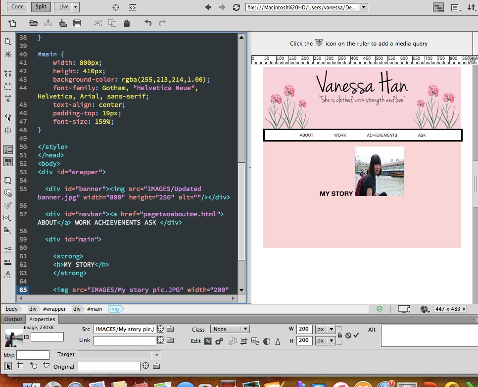

These are my codes.. is there something I did wrong?

I have noticed that Al Sparber gave you some excellent advice (closing gap ). However, in this case it may be a better solution to set images to block-level rather than inline-block level.
To do this change the style rule from
img {
vertical-align: bottom;
to
img {
display: block;
10 replies

There is no element called 'h', it can be 'h1', 'h2' etc. Because the 'h.' elements are block elements, they will automatically occupy the whole line. 'img' elements are inline-block elements, meaning that they are placed inline.
To answer your question, change <h> and </h> to <h1> and </h1> respectively. That will push the image to the next line.
