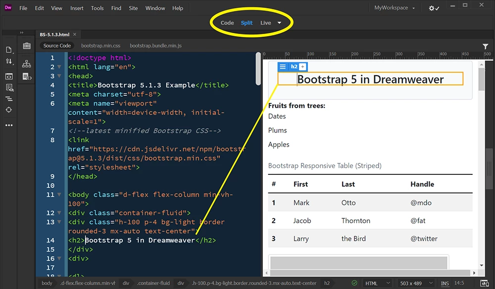

If you used modern software (and you should), DW CC has an improved Live View mode that is superior to Design View.
But alas you're still using discontinued CS6, so it is what it is.
