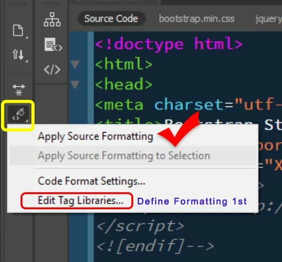

Hit Apply Source Formatting.
You'll find it on the Common (vertical) Toolbar as shown below.
Nancy

Personally, I am no fan of indented code. But if you want your code indented you must define it first in Tag Libraries -- either globally or for each tag.   Once your formatting is defined, hit Apply to save.  Then use the Apply Source Formatting button.   Since I use this quite a bit, I have a keyboard shortcut for it.
