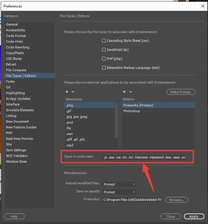

    Double-check that your preferences are set for Dreamweaver to recognize .htaccess files:
    Hope this helps! Make sure to press "✔ Correct Answer" on this post if this answers your question. Happy Creating!Anissa • @anissat
