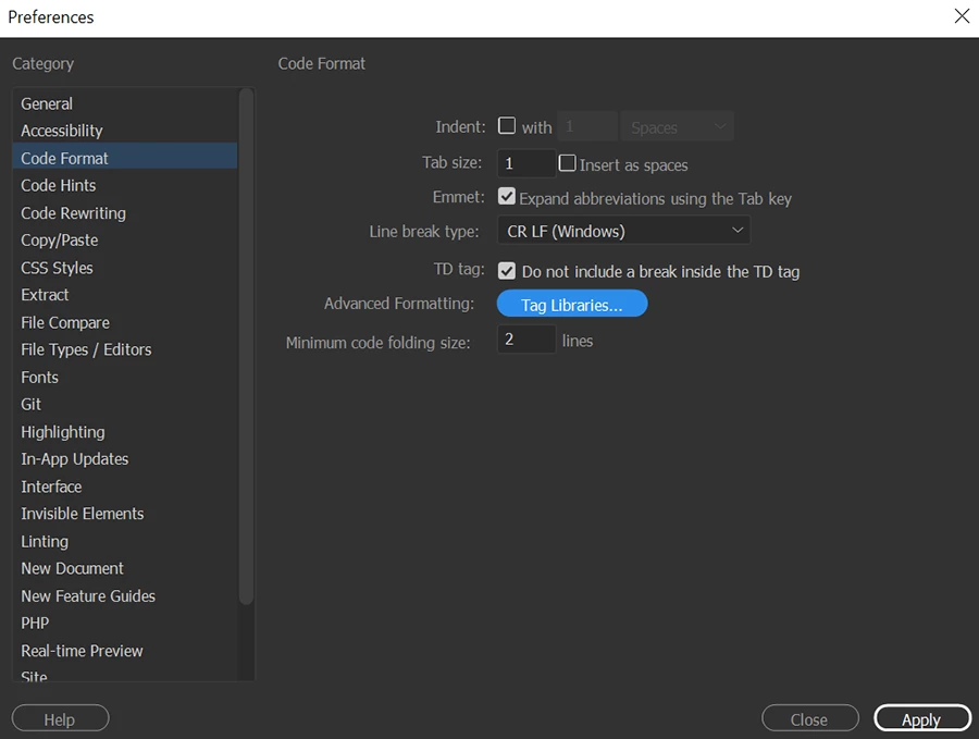

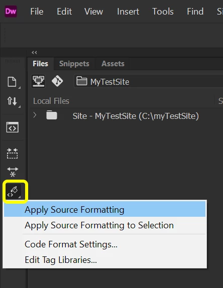

You set up desired code formatting in your Preferences panel.  Code Formatting > Tag Libraries.  You'll need to do this for each tag.  That said, I prefer to work with unindented code so mine is turned off.
Once completed, Apply Source Formatting.

Thanks Nancy, that got me part way to a solution. But when I select Tag Libraries and go to the tag I want to modify, I can't see how to make the changes I want. Can you explain those steps?

Select TAG.  Click on Line Breaks.
Select one:
  • No line breaks.
  • Before and After Tag.
  • Before, Inside and After.
  • After Tag Only.
That's the extent to which you can format automatic line breaks in code.
If you require more than that, you'll need to add line breaks manually in Code View by hitting the Enter key.
