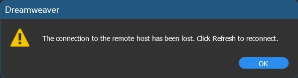

I keep losing connection to server
When I try to upload to my website server (FTP) I keep getting drop-outs like this:
I was able to use FileZilla to access the server fine so I don't know what is causing the issues but it seems to be a Dreamweaver issue. I have given Dreamweaver access through the firewall (Windows Defender) to no effect. Temporarily disabling the firewall also didn't resolve it.

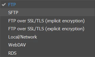

Update: I seem to have figured out a solution although to be honest I'm not quite sure I 100% understand it.
In the site setup window there are different options for "Connect using". I was using the FTP option and as a test try to different options for "Connect using".
When I switched to Connect using: SFTP I was able to connect to the server. That is secure ftp.
It's possible that the connexion was blocked from the hosting side for security reasons without me realising because I was trying to use standard FTP.
Tl:dr - Try using SFTP instead of FTP to connect.

When in doubt, ask your hosting provider which connection method they require you to use.
It varies by server and type of hosting plan you have.

Time outs can happen when Dreamweaver is idle.  For security reasons, I disconnect from my server when I'm editing locally.  And then reconnect manually when I'm ready to transfer files to the server.
If your server is timing out during transfers, that could be a problem with your internet connection.

I find it discconnects after ~5 minutes

So does mine if it's left idle.

Have you tried everything here:
https://helpx.adobe.com/dreamweaver/kb/troubleshoot-ftp-issues-dreamweaver-cs6-cc.html
...especially toggling Use Passive FTP and FTP Performance Optimization (toward the bottom of the page)?
