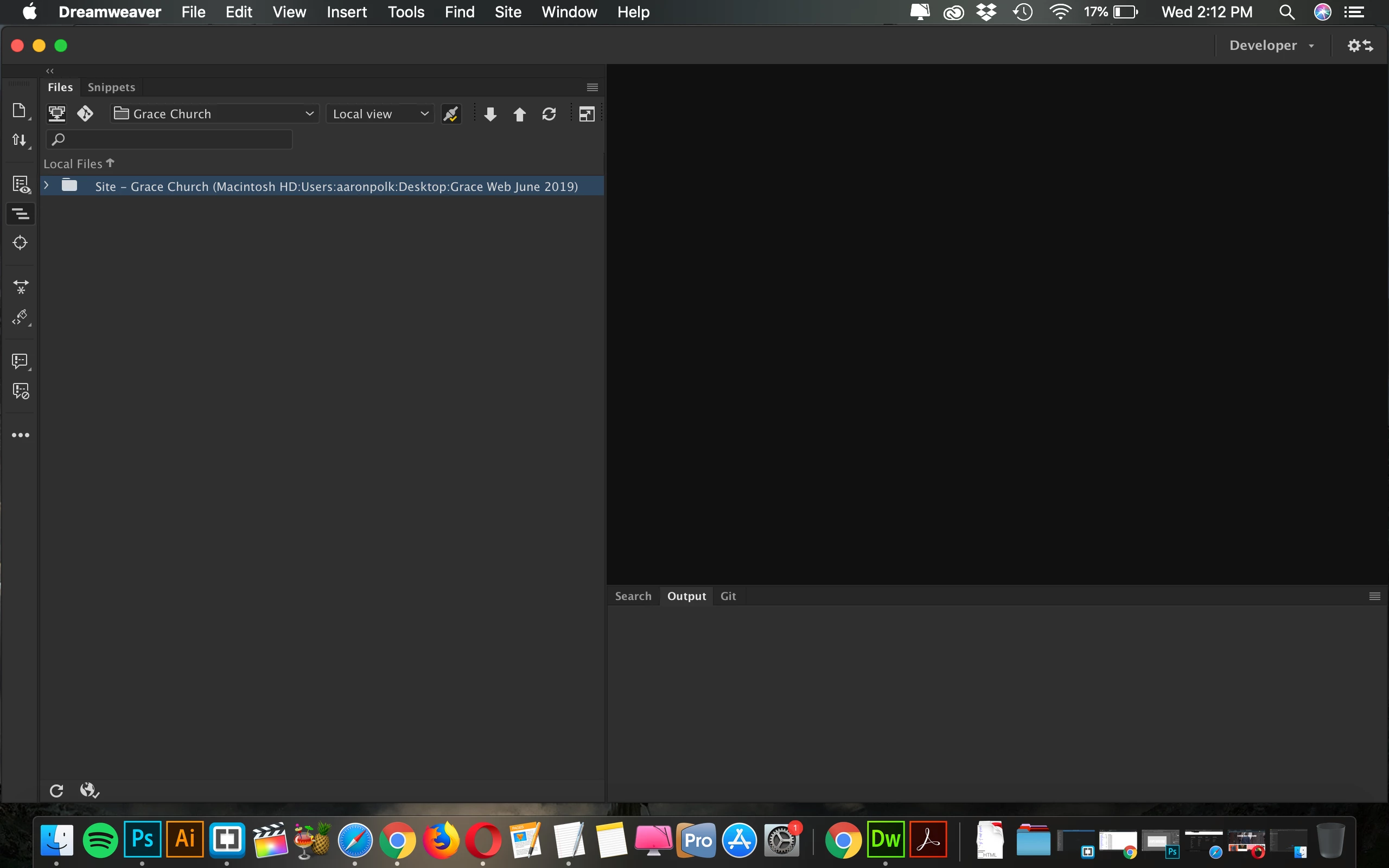

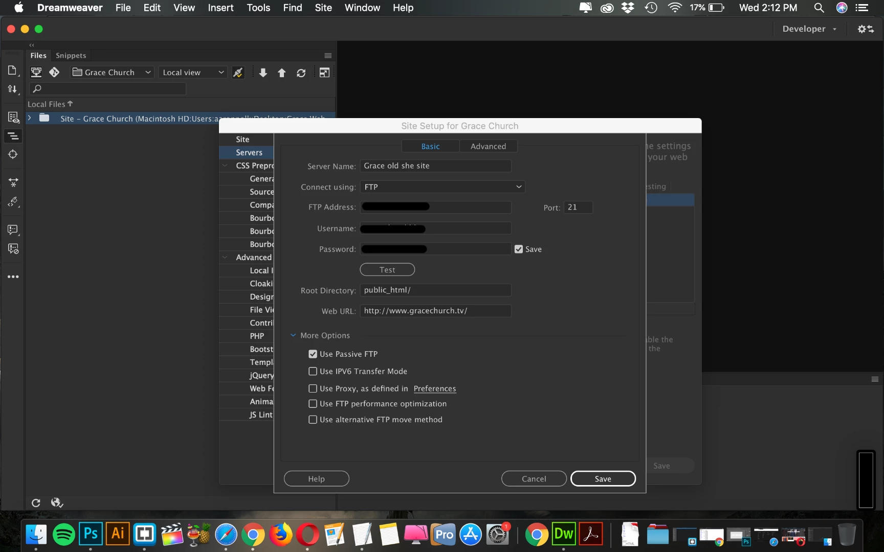

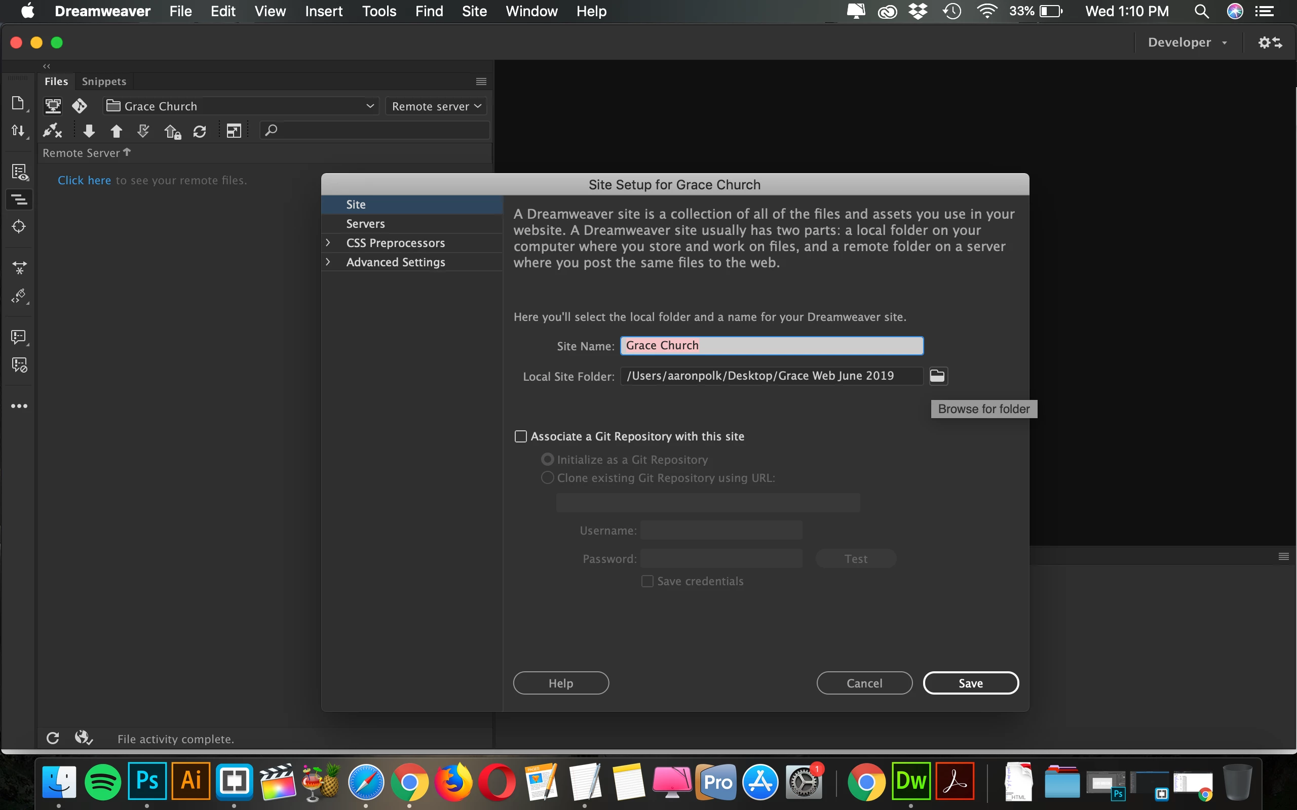

Jul 24, 2019 6:21 PM UTC
There is nothing inside the resource folder. Where Im confused is the local site seems to be set in the picture to the html folder and as for the remote server.... How and where do I separate the them as well as well how do specify where the server root goes to public_html? I'm trying to get out of changing code.. because I'm not a master coder and I didn't change it in the first place so something has goofed up.? I'm not sure how or why?
[Moderator Note: Backed out sensitive info in screen capture.]
Jon Fritz
Jul 24, 2019 7:13 PM UTC
Nope, in your screen shots, the Local Root Folder is set 1 directory level above the HTML folder and ends at the "Grace Web June 2019" folder.
You need to add /HTML to the end of that path in order for DW to recognize it as your local root.
Your remote root is already correctly set as public_html in your screenshot.

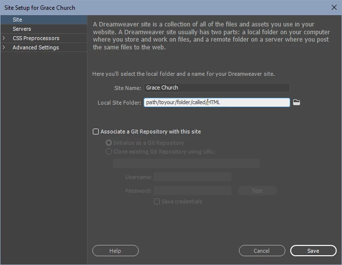

OK...
In that case, you'll need to modify your DW Site Definition to tell the program what should, and shouldn't, be uploaded.
1. In DW, go to Site > Manage Sites
2. Click the site you're working with and hit Edit (Pencil icon)
3. In the dialogue that pops up, make sure the Local Site Folder is set to the HTML folder that holds all of your site's files...
...that will ensure only the content of the folder is uploaded to your site root, vs uploading the entire folder (and breaking your links).
4. Click Save
5. You should now be able to upload the site and overwrite the correct files by clicking on the "Site - yoursite name" (the top line) line of the Files window and clicking Put (up arrow)
6. Test the site online
