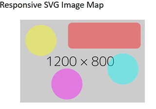

    Hi @defaultb6gpvtgomtuq,
    Do not use Photoshop to generate code for you.  It never works well in production.
    Old fashioned client-side images maps won't work in responsive layouts.  The hotspots invariably fall out of register when the image is resized which creates massive usability problems and frustration.  So that's no solution.
    Best advice is to manually code with SVG images.  Or avoid interactive maps if you possibly can.
    For this proof of concept, I used a few math-based SVG shapes layered over a responsive, raster background image.  Each SVG shape links out to another URL.
    You can see the code and a working example on JS Fiddle below.  Resize your browser viewport to test it.
    https://jsfiddle.net/NancyO/6k3v4ge1/21/
    Hopefully this will give you a starting point to work with.  Post back if you have any questions.
