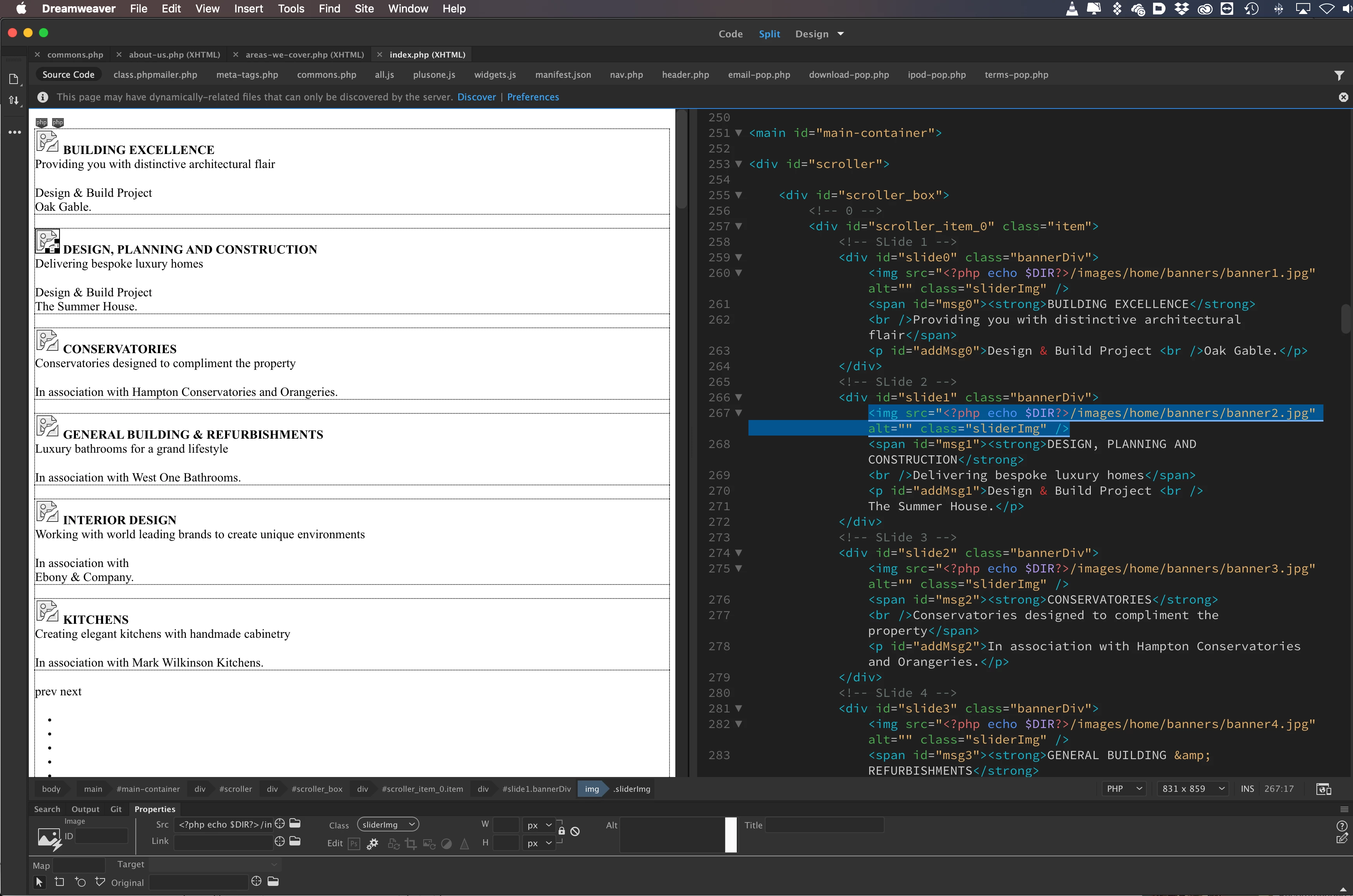

Images not displaying in Design View
How do I get images to display in the design view?
The images has a PHP code to them with <?php echo $DIR?> at the beginning.
The images appear in the live preview which obviously then runs the PHP server script.

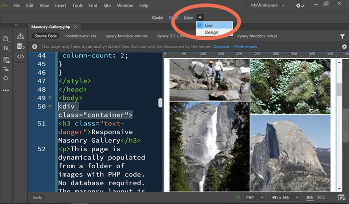

You can't in design view because of the server side/PHP code.
Either preview in browser or use live view

marnix-garner
Aug 14, 2019 12:20 PM UTC
I already have since setup MAMP properly but it won't preview in the 'Design' mode, only 'Live' mode but this is no good as one can't select .i.e a picture or element for it then to select the code in the 'Code' window (using split screen).

Aug 6, 2019 6:55 PM UTC
Switch to Live View.
Design view is mainly for plain vanilla, static HTML rendering.  It cannot parse PHP code or handle advanced CSS.   Design is useful for quick editing of text, DW templates and image maps.  But beyond that, it has little value.

marnix-garner
Aug 14, 2019 12:18 PM UTC
How does one work blind like this!!? When looking at the code to make amends, it's such a slow process to find what you are looking for quickly without any 'live' preview. One would select i.e. a picture in Dreamweaver 'design' view and then it would select the code in the 'Code' window for normal HTML sites. Wondering how people work efficiently with PHP sites? (Do people use different software?)
To work like this adds many, many hours to the job! Any suggestions on a better process would be greatly appreciated.
