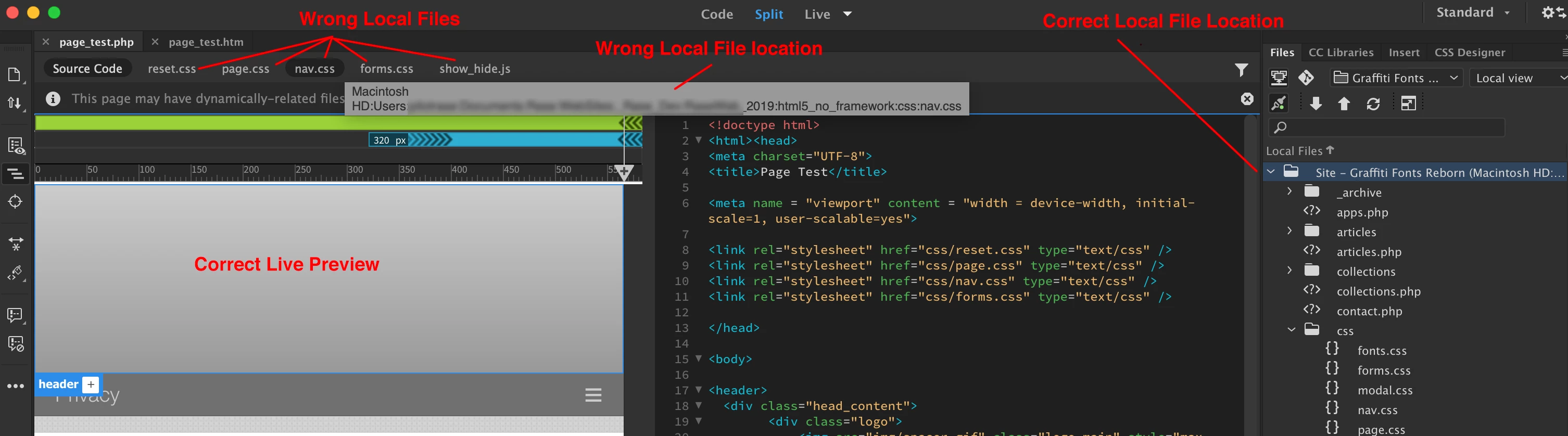

    I've added a new experiment to illustrate the issue more simply.
    I created a new file, very simple, all static html code,  no php or server-side code of any sort, Just enough page elements to prove that the correct css files are being used in the live preview & the wrong ones in the "Related Files" panel.
    I copied this .htm file & changed the file extention to .php. Both versions are on the top level in the local site & in the same location on the remote testing server. Both files are identical other than the file extention. The only related files in this example are static css files & a small .js file all of which are linked with relative locations as shown in the images.
    When I open the .htm version Dreamweaver will show the correct related files. When I open the .php version Dreamweaver will show the incorrect related files. In both cases, the live preview, design mode preview & real-time browser preview are all correct & being rendered from the correct related files (css files). In both cases Dreamweavers file browser shows the correct files in the correct location.
    Simply changing the file extention to .php causes the Dreamweaver "Related Files" panel to switch from showing the proper, local location for the array of related files to showing a different, incorrect local location for the related files.

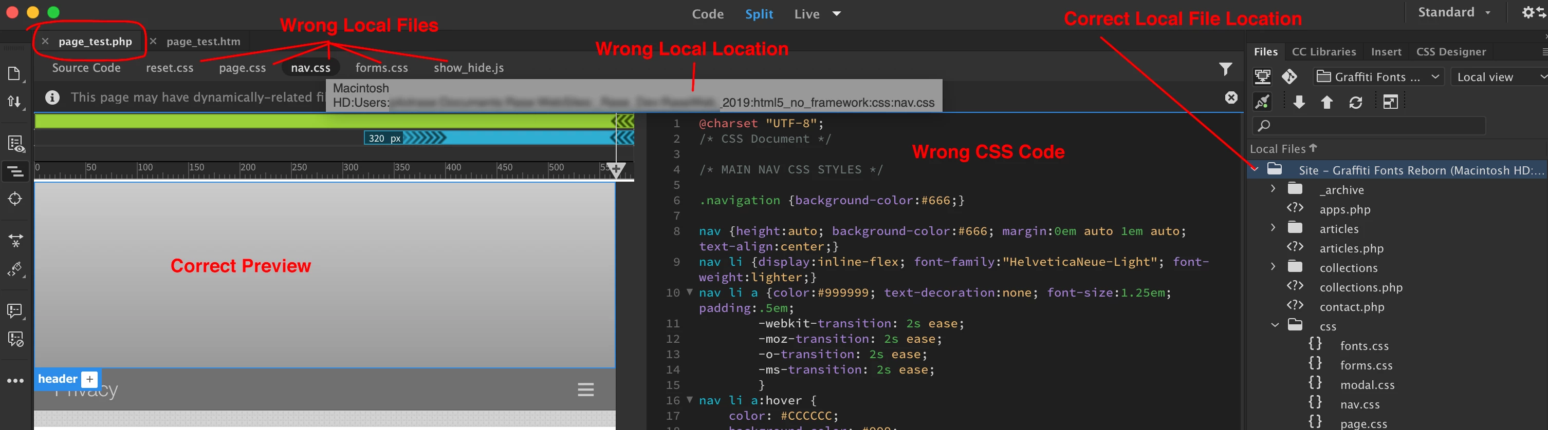

    September 18, 2019
    Now,  having deleted all of my Dreamweaver sites, In the Mac finder, I've created a new directory, copied all of the files from the  old site to the new directory & set up a new dreamweaver site & testing server from scratch using this entirely new directory. Same result.
    The local files & remote testing server files remain completely intact after syncing. Everything previews in every view mode and in the browser just fine but the "related files" panel is still showing me the files from a totally different directory no matther which file within this newly generated site I open.
    The only method that works to display the proper related files is to cycle through the view modes as I explained earlier. The correct files are displayed briefly as the file loads then once the live view is rendered the related files panel switches to displaying the wrong files WHICH ARE DEFINITELY NOT THE FILES BEING USED TO ACTUALLY RENDER THE PREVIEW.
    How could/why would the files shown in the "related files" panel not be the files used to render the actual preview shown in the live preview?? Obviously the live preview & real-time browser preview are coming from the remote testing server but those files are fine as are the local files! The "related files"  panel is just showing totally different files that are not in the local site or the remote server. They're just different files from a differnt local directory elsewhere on my hd.
    Something about the live preview mode is invoking this glitch in the "related files" panel thats showing files from a totally different site that happen to have the same file names.
    My mac is set for all hidden files to be visible & I don't see any residue of anything in the site directory itself but there must be something somewhere that is associating this site directory or files within with this other site. It seems likely that thes identical file names must have something to do with it.

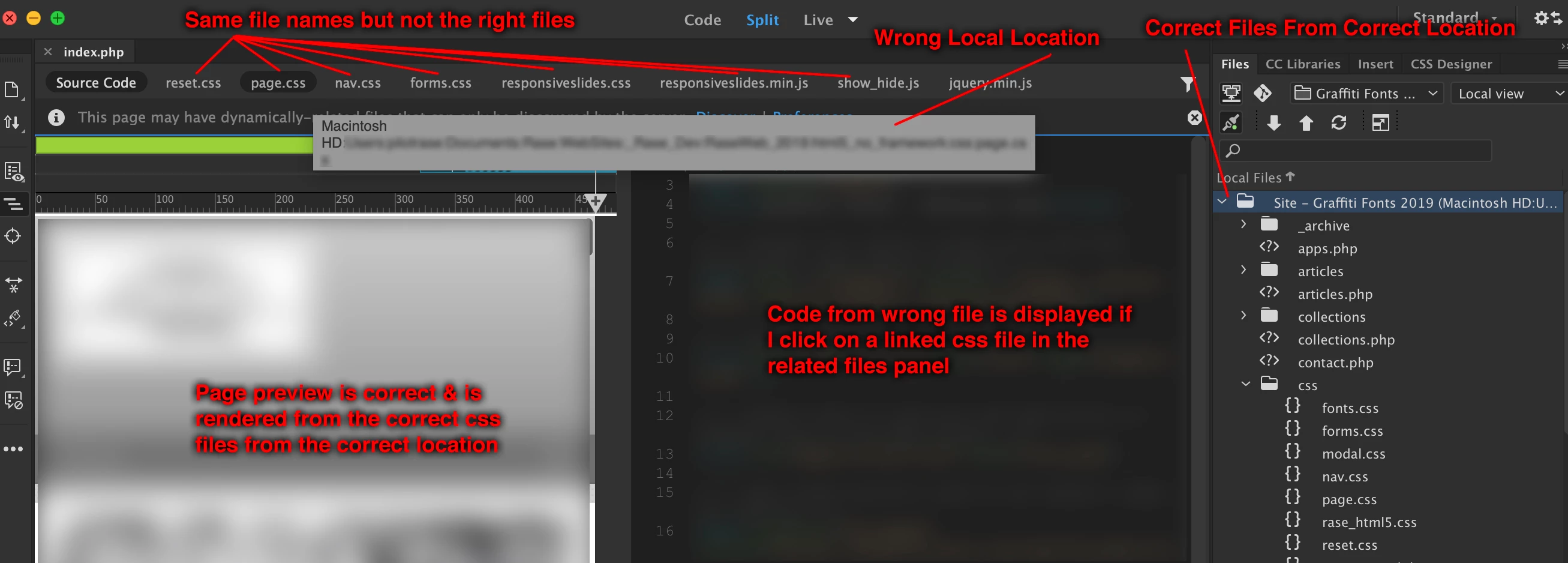

    September 18, 2019
    This image might help clarify the issue.

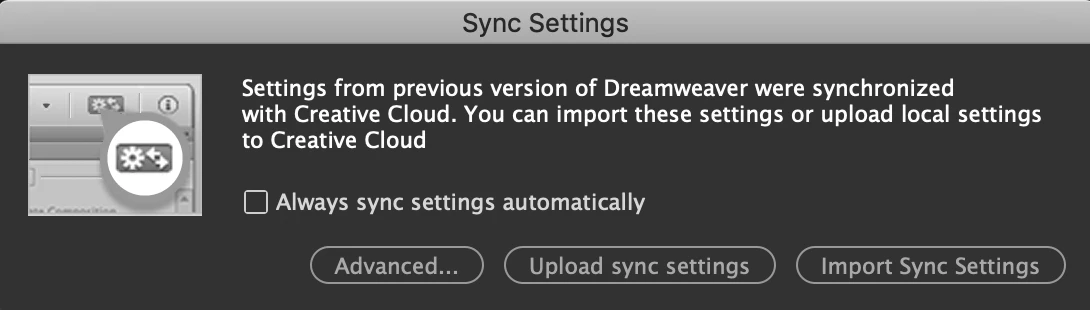

    Each time I reset the pref for Dreamweaver I get this message:
    I'm suspcious that these old settings could be responsible for this stupborn problem. I've tried to use the option to "upload settings" thinking it might upload mu new settings and overwrite the old but no luck. There does not seem to be a way to purge the old settings or stop Dreamweaver from importing them.
    Any Clues?
