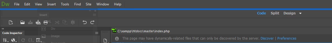

    1. Open the Insert panel under Window > Insert
    2. Click and drag the named tab of the insert panel up to the top of the application frame until it ghosts itself and a horizontal highlight appears as shown here...

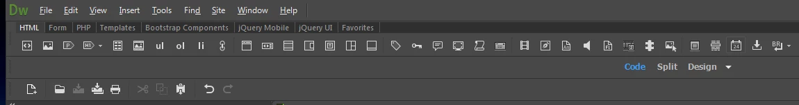

    3. Release the tab and the insert panel will turn into a toolbar as shown here...

    All you should need to do is...
    Feb 10, 2017 7:15 PM UTC
    Thanks! I was trying to drag the actual Insert tab and not opening it from the Window dropdown first. I've used Dreamweaver since it came from the old Homesite days...not sure why I had such a senior moment! Thanks!
