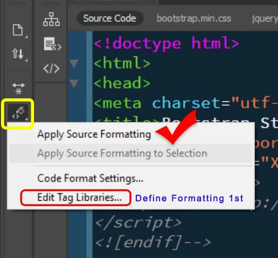

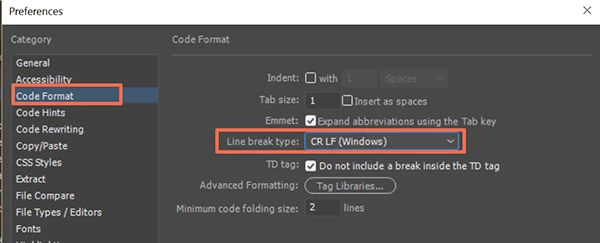

Windows & Macs use different Line Breaks.  See screenshot from Preferences.
Apply Source Formatting may help to clean it up.
Nancy
JaySprout
JaySproutAuthor
Apr 15, 2017 3:24 PM UTC
