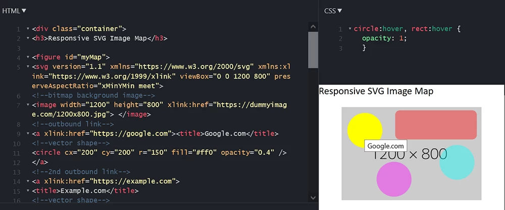

    For better usability on all devices, best to stick with individual linked images.  Or use SVG shapes and manually code the shapes with links as in this example:
    https://jsfiddle.net/NancyO/6k3v4ge1/21/
