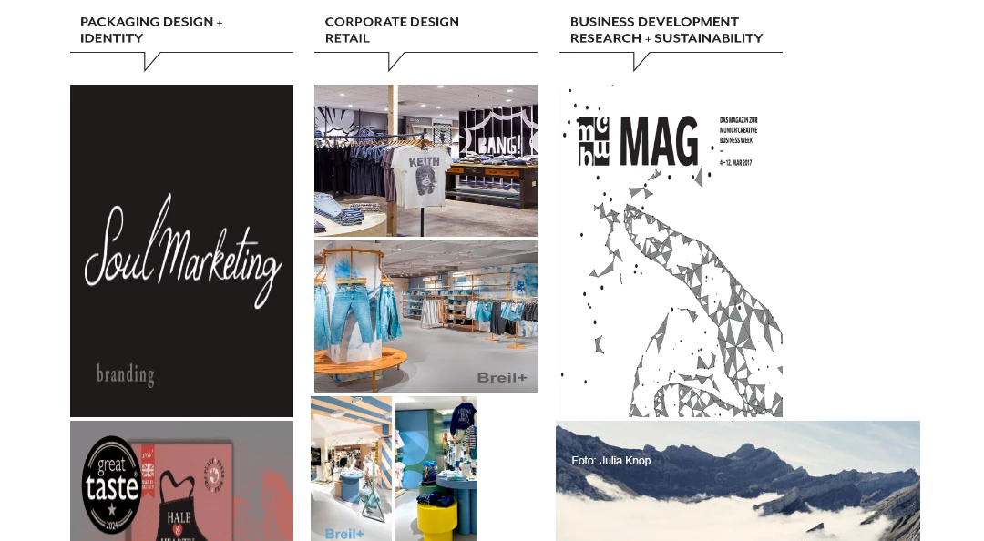

Hi

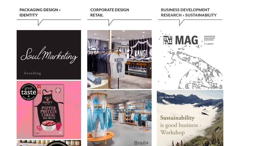

sth happened to the grid here and I can't figure out what exacly is wrong. can anybody please help? The images are all distorted and should look like the second image. What do i need to change please? Thanks a lot

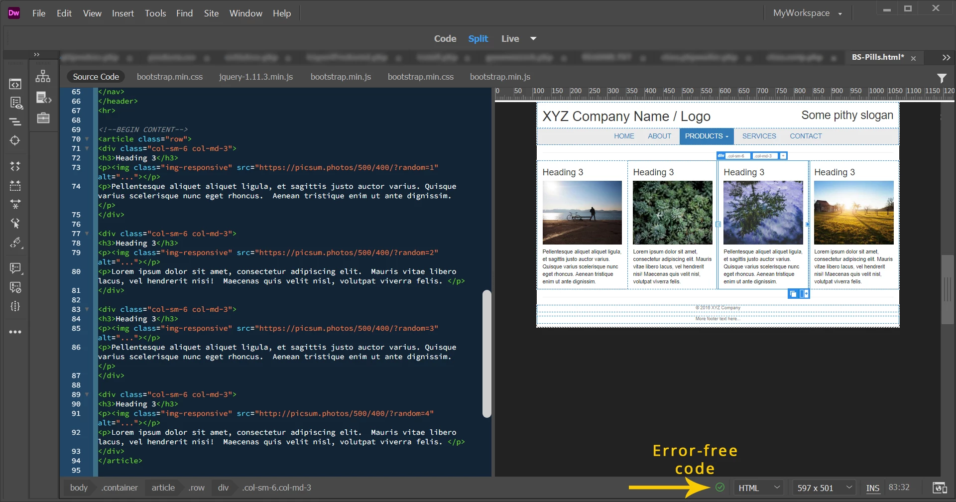

    When layout failures occur, it's almost always due to code errors.
    First, validate code & fix all reported errors.
    Window => Results => Validation...  Click the Triangle to Check Document.
    Images typically fit inside the width of their parent container(s).
    In this example, I'm using
    tags with Bootstrap col classes.
    • Responsive images scale to fit the width of their
      containers— 2 columns on small devices, 4 columns on medium & large screens.
    • The green checkmark on the bottom of my HTML document tells me my code is error-free.
    Post back if you need more help.

    Images don't tell us much, when they display properly (yours didn't come through in the forum).
    My guess would be you have a setting in your css causing the images to be narrower than 100%.
    Could you please post a link to the page in question, or a distant second, post the entire code of the page to a forum reply?
