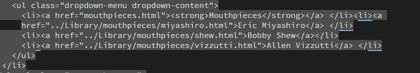

    Mar 8, 2018 7:45 PM UTC
    So why does it do it sometimes and other times it doesn't.
    This pictures shows fours links, the first one works because it doesn't have Library in front, the other three links don't work and then were all done the same way. If I viewed the whole page of about 25 links now of them have Library in front of the link.
    This only seems to happen on the onset of creating new links then somehow it disappears. Why?
