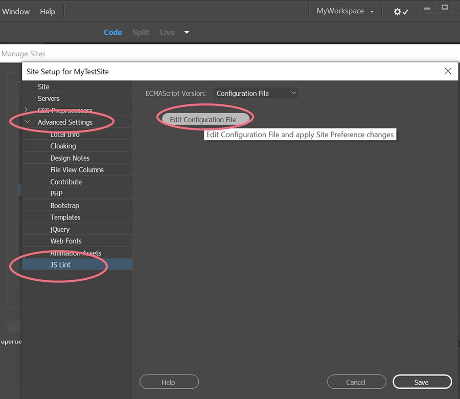

Nancy OShea
Oct 6, 2021 9:44 PM UTC
Optionally, you can add it to JS Lint Configuration File from Site settings.  See screenshot.
