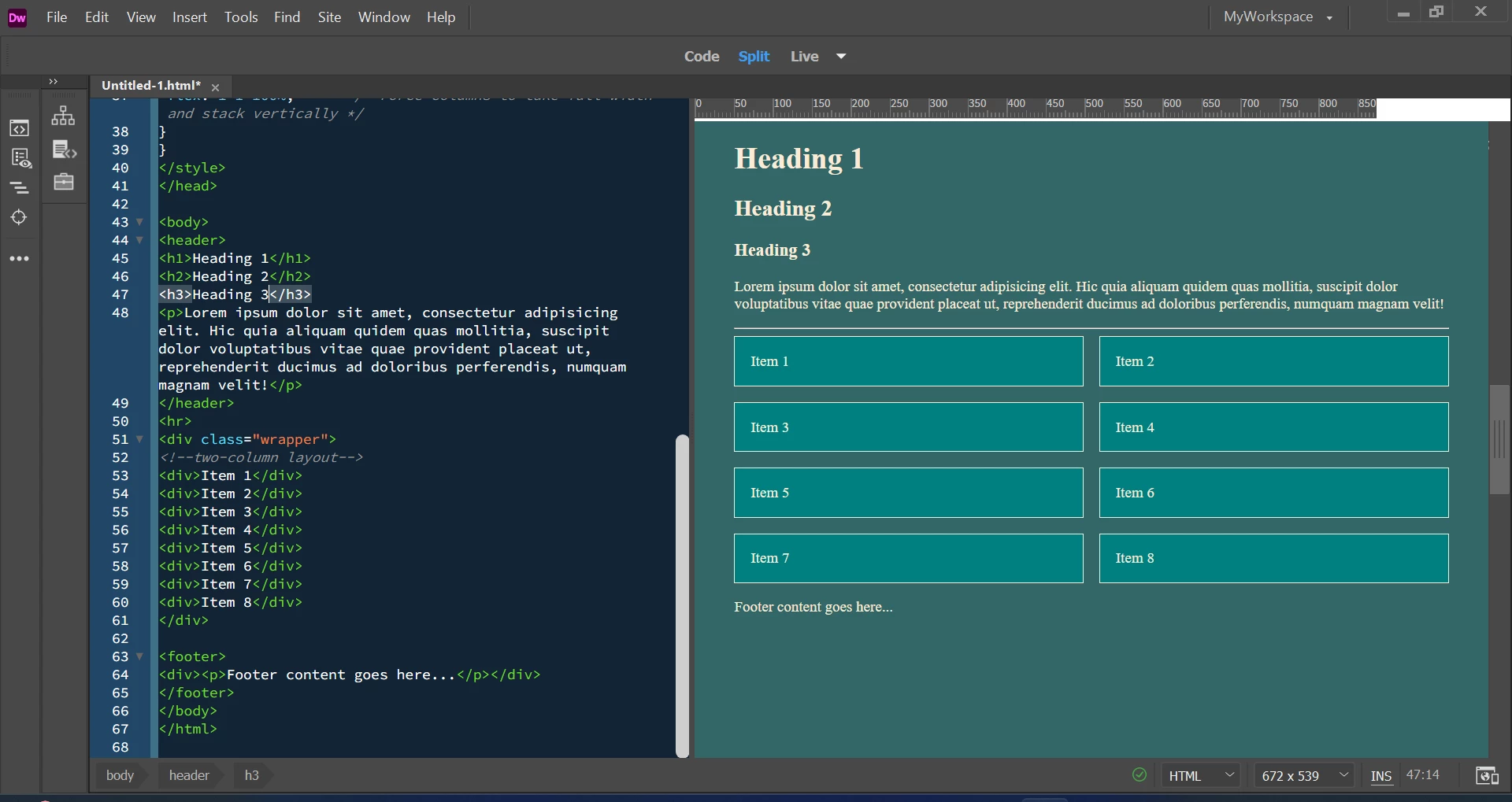

    A basic 2 column layout:

    And this is what it looks like in Live View.
    Post back if you have any questions.
