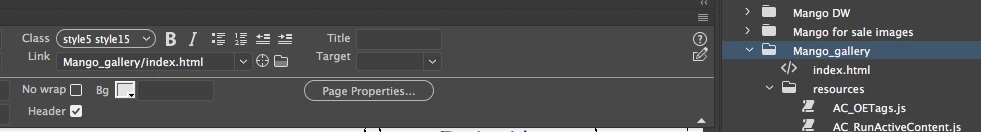

Link not working, The requested URL was not found on this server (phoenix)?
Works fine in real time preview. Using DW CC 2018 on mac. Have taken over this site for a family member, I am a beginner at DW. I made sure that the correct file is linked for this web gallery. The link is Mango_gallery/index.html. the real time preview address is http://127.0.0.1:49393/preview/app/index.html
Any advice, besides this site is old and a mess. lol

    Oct 5, 2018 5:28 PM UTC
    http://www.windwalker8a.com/forsale.htm
    Real time preview works. And after uploading  and visiting the actual site, that where I get the "The requested URL was not found on this server (phoenix). " It appears the case structure is identical.
    Have you uploaded the Mango_gallery folder and its index.html page to the server as well?
    That won't happen automatically when you upload the forsale.htm page.
    If you have uploaded the folder and file, it would likely mean it has been uploaded to the wrong location. According to the link itself, there should be a folder called "Mango_gallery" on the same directory level as your forsale.htm page. If it got uploaded to any other location, the link won't work until you move it to the correct location.

    Oct 4, 2018 7:19 PM UTC
    That address is not accessible by anyone but you. It's actually Adobe's server, running your page in a frame.
    If you want to see what your page will actually do, you'll want to right click the document's named tab (if documents are set as tabs in DW), or right click on the name of the page in the Files window, and choose Open In Browser. That is the old Preview in Browser and will show you the page locally, without using Adobe's servers and creating addresses that don't exist.
    If the problem still exists there, we would need to see the page on a publicly accessible server (meaning you'd need to upload it to at least a test location on your server) or a distant second, copy and paste the entire code of the page to a forum response. Don't use email to reply, code won't come through to the forum.
    Oct 5, 2018 3:26 PM UTC
    The broken link is line 168 the word HERE there are 2 Here's but it the first that says click here for more pictures. This code is a mess, but I just need to get the link working for now.
