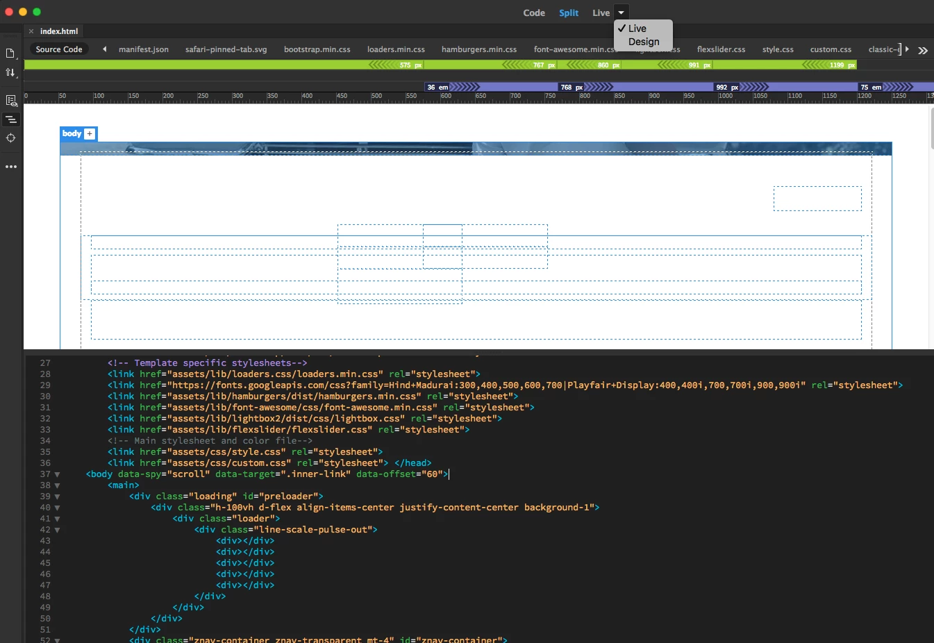

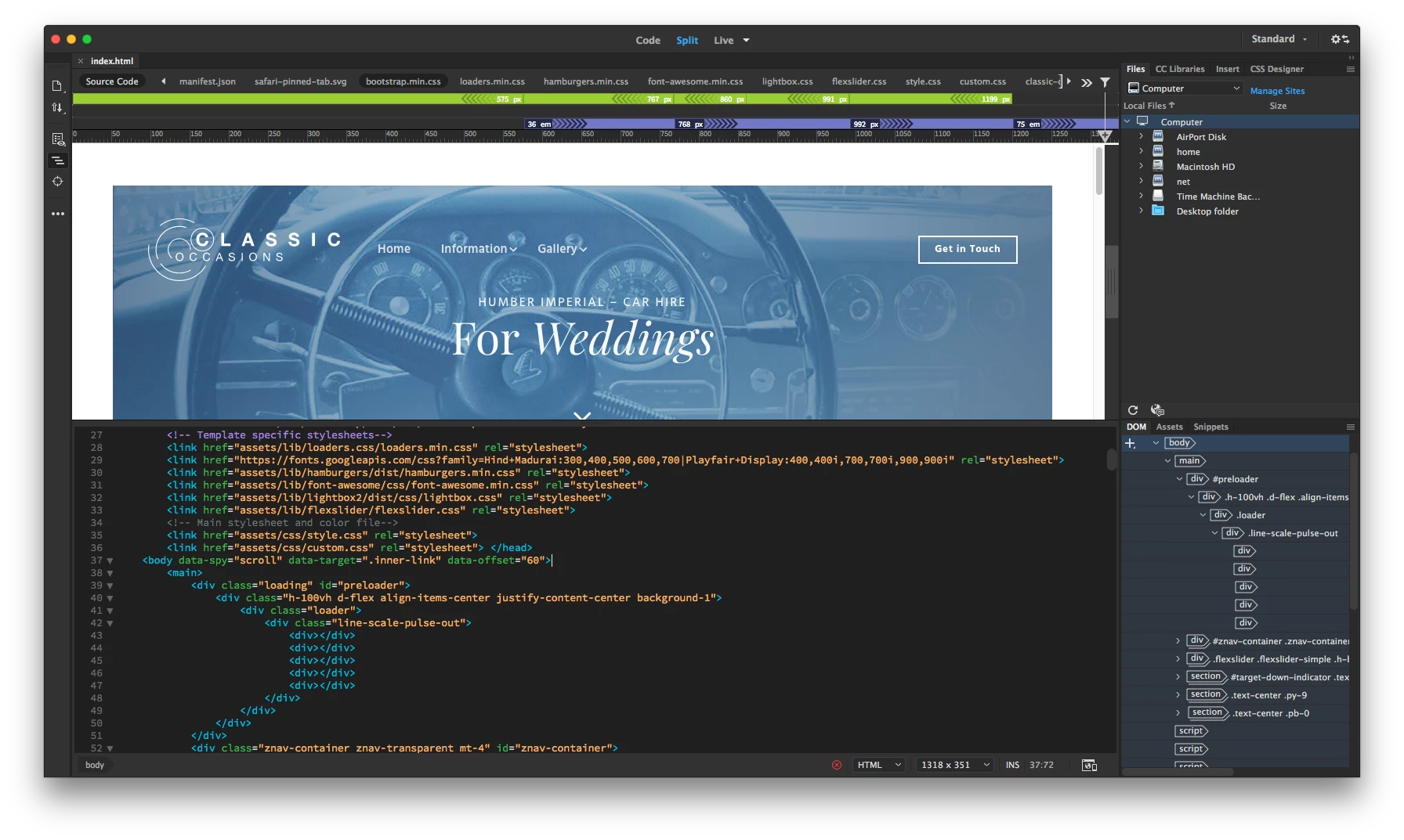

I have a layout that uses a HTML5 bootstrap theme. On my old workstation dreamweaver shows everything fine, however, my new Mac with dreamweaver shows the layout when I refresh the view with F5, then changes to showing dotted lines and div shapes.
What is going on? Why does it not do that on my old Mac running exactly the same version of dreamweaver CC?
Please see screen shots attached.
Thanks

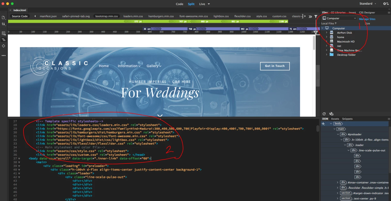

Have you tried checking your paths?  I noticed that your screenshot shows that your Files Panel is not set to your current file's project (1); this means that Dreamweaver may not be tracking the paths to your style sheets and assets properly if you don't have absolute paths in place (2):
See what happens if you select your site definition from the Files Panel's project drop down list...

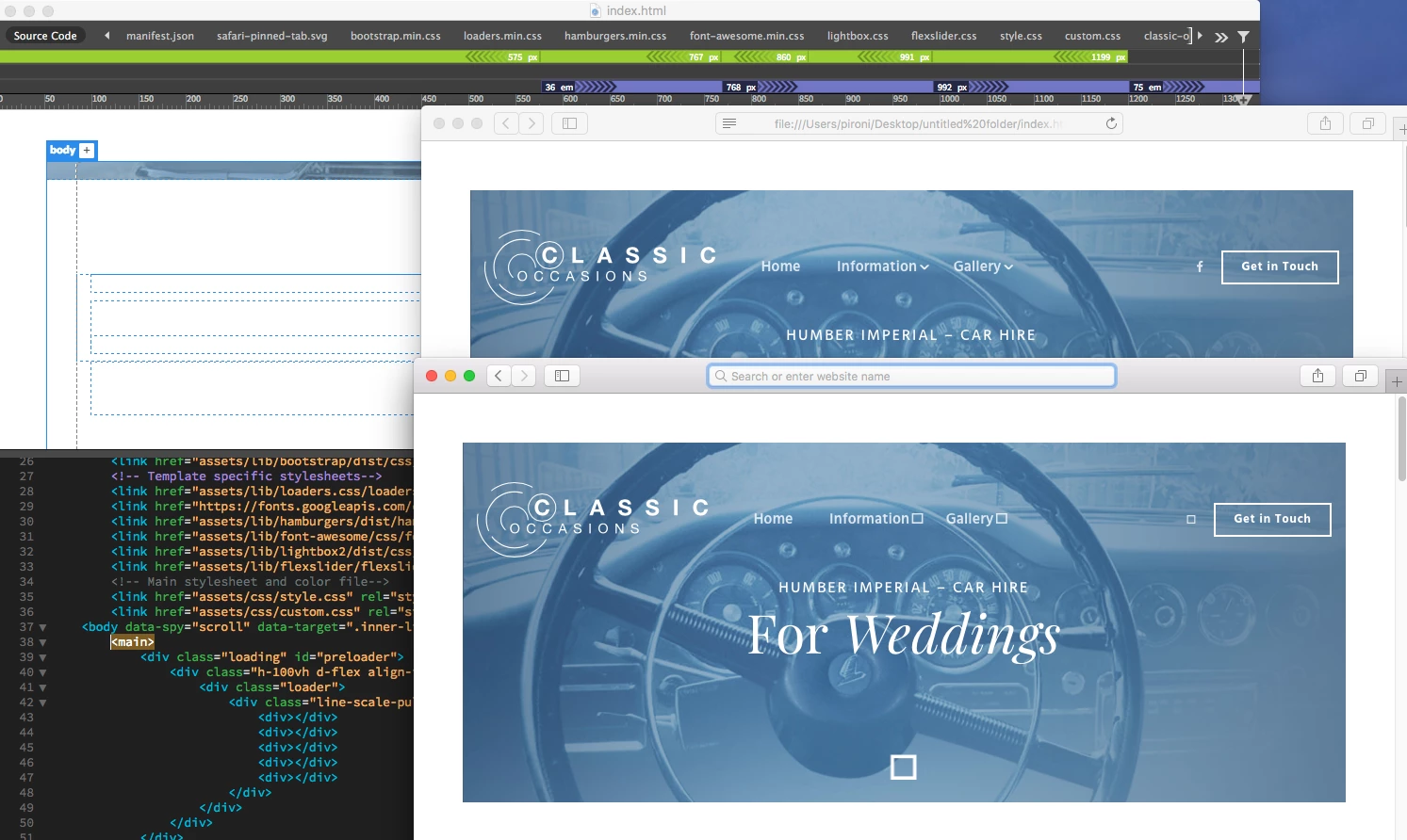

The entire content build is in my iCloud drive folder. I have copied all the files to a folder on my desktop to ensure it wasn't a problem with being on my iCloud Drive folder but the problem persists.
When I open the html file in any browser everything loads fine.
When I open the html file on my Mac at work the Live Preview in Dreamweaver loads everything perfect.
I have  uninstalled Dreamweaver and re-installed it and nothing resolves the problem.
Please see the screen shot attached. It shows the live preview with all dashed lines not showing the content properly. It shows browser window (top one) that has the html file directly opened and views perfect. And it shows another browser window (bottom one) that has opened the content via OptF12, this displays the loaded page but is missing some linked symbols (down arrows and Facebook f symbol) that I know are linking to an online location.
Why would the page not load properly on 127.0.0.1 when its a loop back?
I think the issue maybe a network issue, but I don't know how to resolve this.
