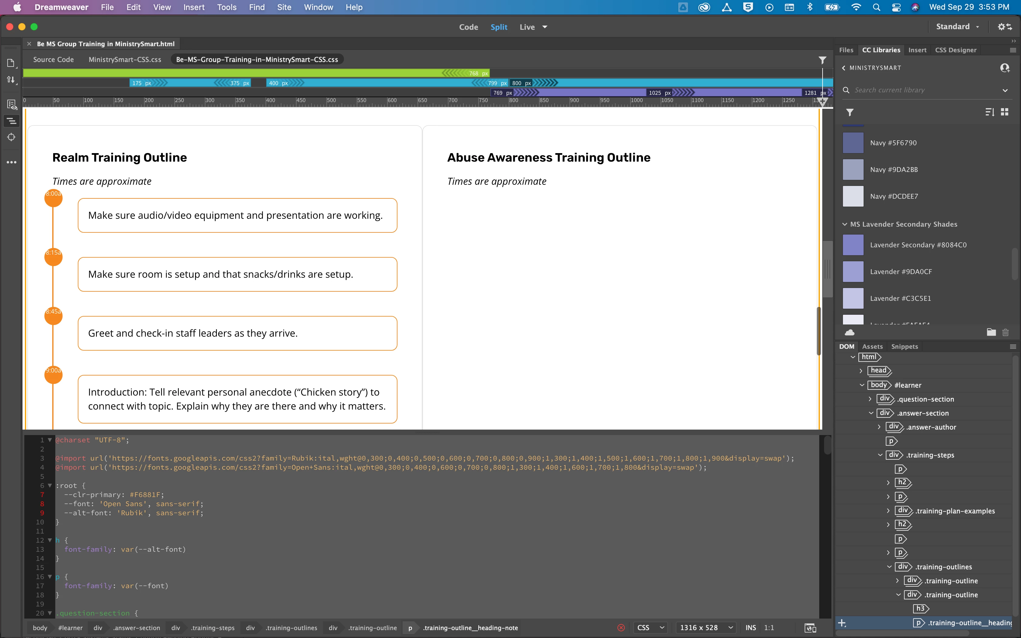

Running the validators did catch two mistakes that I had made but over all live view has been resistant to updating or picking when it wants to update.

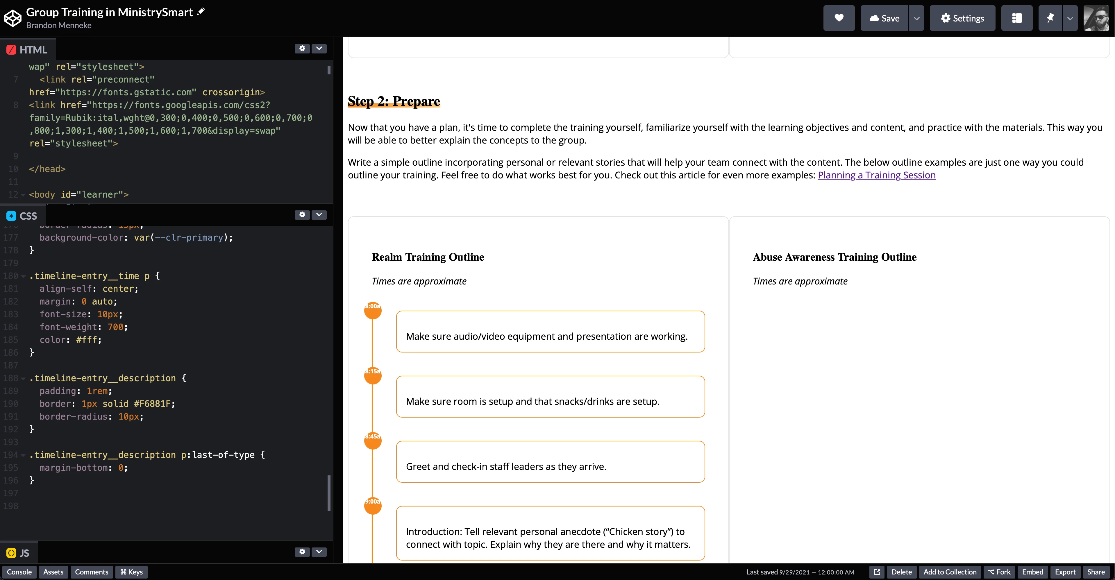

I could change a margin value and it not update then swich to another program come back and all the sudden it has updated that value. I've also taken my code and ran it on Codepen and it displays how I want it to. Dreamweaver behaving the way it is, is slowing down the whole process.
Here is the Dreamweaver part thats not updating at the moment. The space between "times are approximate" and the beginning of the timeline.
And here is the same thing in CodePen.
Nancy OShea
Sep 29, 2021 8:17 PM UTC
Save all documents.
Switch to the HTML Source Code Tab.
Refresh the screeen (F5).
Assuming there are no critical errors in HTML or CSS code, it should render.  However DW is NOT a browser.  For best results, always preview your work in real browsers and mobile devices.
