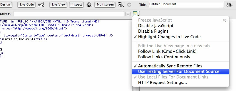

What does the URI say in the address field of the Live View toolbar? If the URI looks like "file://.../page.php" or "file://.../page.html" with the word "file" at the front then the live view source is getting read straight from the disk instead of going through your webserver and the php processor. Go to the Live View Options menu and select "Use Testing Server for Document Source". This should force Live View to get the page through the testing server and hte URI should start with "http" like "http://localhost/.../page.php". By default in Live View static html pages are read off the disk as "file" while dynamic pages like php use the testing server and start with "http". The initial page you opens determines this for all the links you click on, so if you open an html page first it's going to use the local "file" for all the relative links. You could also fix this my opening a php page first and following that link.
Here's an image of that setting that controls this:
Hope this Helps,
Chris
Hope this Helps,
Chris
