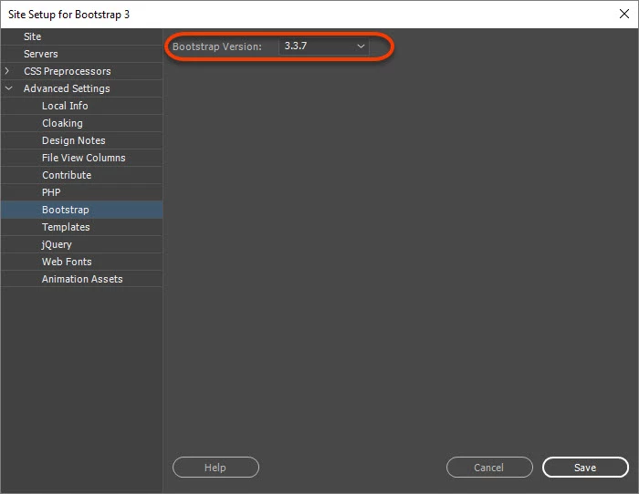

    David_Powers
    Mar 14, 2018 11:04 AM UTC
    DW CC users should be aware that Dreameaver CC 2018.1 uses Bootstrap 4 by default for new projects. If you want to create a new project using Bootstrap 3, you need to set the version first in the Site Setup > Advanced Settings > Bootstrap panel.
    Existing sites using Bootstrap 3 are automatically recognized as such, and the Insert panel and Insert menu toggle between the different versions of Bootstrap depending on the versions of bootstrap.css and bootstrap.js attached the the file that's currently active in the Document window.
    Dreamweaver won't insert the wrong type of component even if you have both Bootstrap 3 and Bootstrap 4 files open at the same time.
