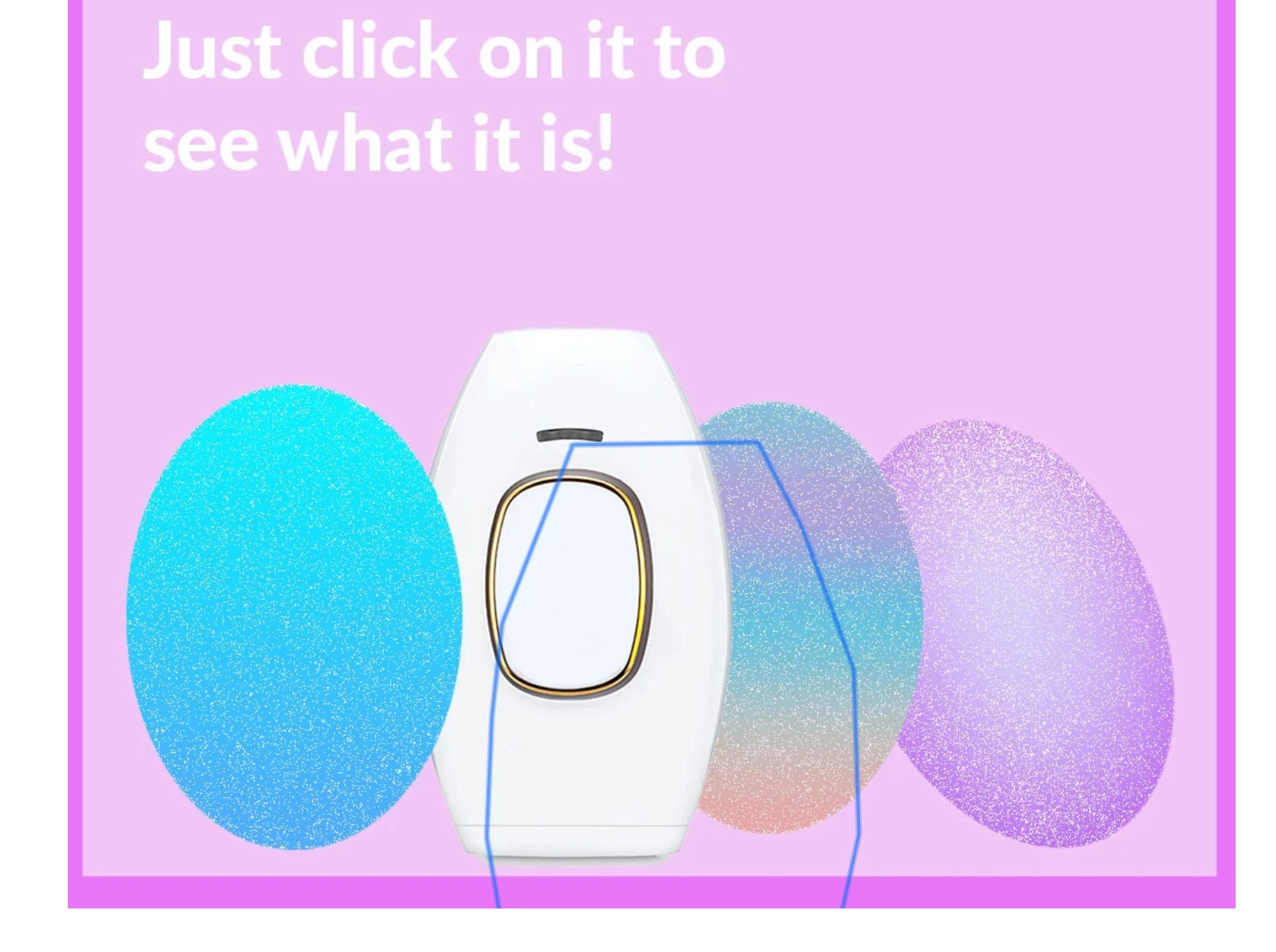

I managed to create an html file with a clickable image AND managed to upload it to my website.  The image is clickable and redirects to the appropriate page but now it leaves behind these icky blue lines?

As Jon says, image maps are not responsive.  Used widely in the late 20th century when everyone had same sized computer displays, image maps are rarely used today.
If you can work with code, an alternative approach is to build linked SVG shapes on top of a responsive raster image.  See working example below.   In smaller viewports, the map remains responsive.

I agree with the others here, it's typically bad form to remove the outline from image maps, from an Accessibility point of view.
I'm guessing the reason you truly want it gone is because it doesn't line up with the image. When you use a standard image map on a responsive image and the image either grows or shrinks away from the size you used to create the map, the <area> tag's coordinates no longer line up with the image itself and cause the offset look you have posted above. The larger or smaller it gets, than the size used to set the coordinates in DW, the worse it gets. Even disappearing from the image entirely in certain cases
You should look into a responsive image map script to use javascript/jquery to take care of the drifing problem. When the outlines always line up with the image parts they're meant to cover, it's not nearly as distracting or noticeable to your viewers.
Something like this works very well: http://mattstow.com/experiment/responsive-image-maps/rwd-image-maps.html

I remade the webpage and now the blue lines stay right above the clickable image, however, now the area that is clickable that is supposed to be directly above the image has decided on its own to move an inch and a half to the right...

That outline visually indicates the linked area, which is important for accessibility reasons (think of someone physically impaired who cannot use a mouse, but only 'tabs' through all the available links on a page, for example).
To remove it set the outline to 0 or none. But it considered VERY bad usability and accessibility practice to do so.
