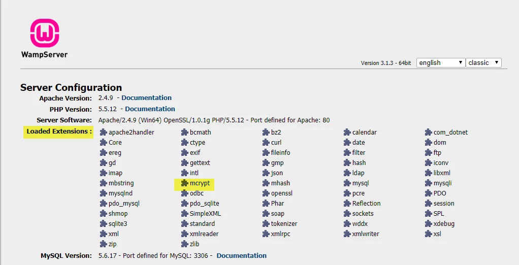

Oct 14, 2018 12:00 PM UTC
When I type 'localhost' in the address bar of the browser, I get the following info
I am not sure if Mamp works in the same manner. I have been told that Mamp is the Mac version of Wamp.
