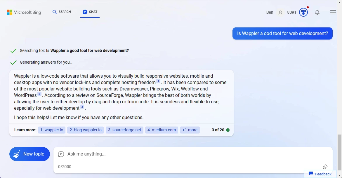

Asking Bing Chat your original question, I get this response:
Maybe you could ask Bing a few more questions to help you. This is another example:

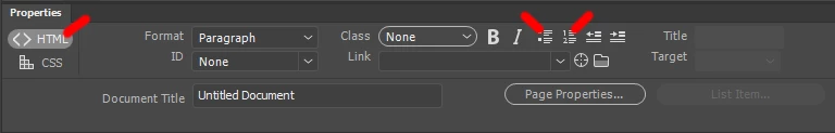

In the latest version of DW, the buttons for Ordered and Numbered Lists can be found in the Properties window (Ctrl + F3 if it's not open). Under the HTML option on the left side...
First, click HTML to highlight it, then highlight the text you want to convert, and click the corresponding button.
If you're not seeing the buttons at all, it would point to an installation problem. Restoring Preferences (even on a fresh install) could bring them back.
