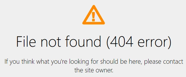

I have two issues going on that I can use some expert advise on.
First, on a website I created, there is an image that refuses to appear called Chariot in the About The Transportation paragraph. I've tried uploading several times, making sure it's in the images folder, changing the name, changing the format from .jpeg to .png and clearing my cache, but it is not there...just the symbol for the image. What am I missing?   http://www.trojansinparadise.com

    "This" is not the same as "this". If you link the file using Dreamweaver, it should have grabbed the filename of the image and inserted it into the code. But if you were typing this yourself, it may not have been apparent. Your "bus" image is not showing because the "b" should be capital like "Bus". As soon as I changed that your image appeared. I realized that because when I quickly looked at your code you were capitalizing every other image name.

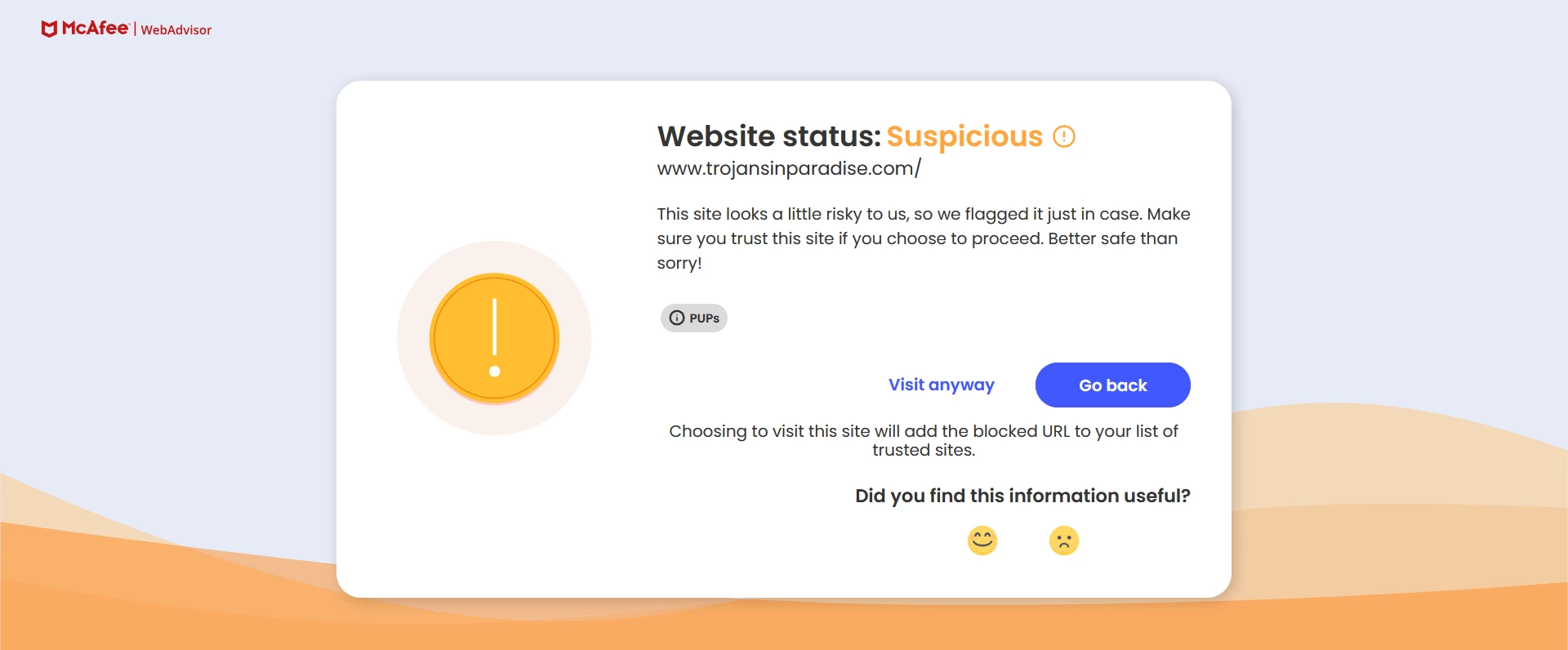

    It's fair to say you have bigger problems that have nothing to do with Dreamweaver.
    Your site appears to contain PUPs -- Potentially Unwanted Programs that could compromise user's security or privacy.
    See Suspicious Warning below.
    That said, I'm not interested in pursuing this. That's beyond my volunteer pay grade.
