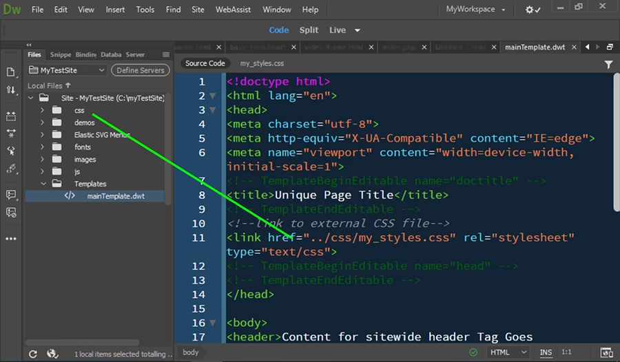

Nancy OShea
Jun 17, 2018 7:59 PM UTC
It's looks like you're using Root Relative links.  See screenshot below.  My template contains a link to my external CSS file but it's document relative (../css/my_styles.css).
Try changing your links to document relative and see if thiat helps.
