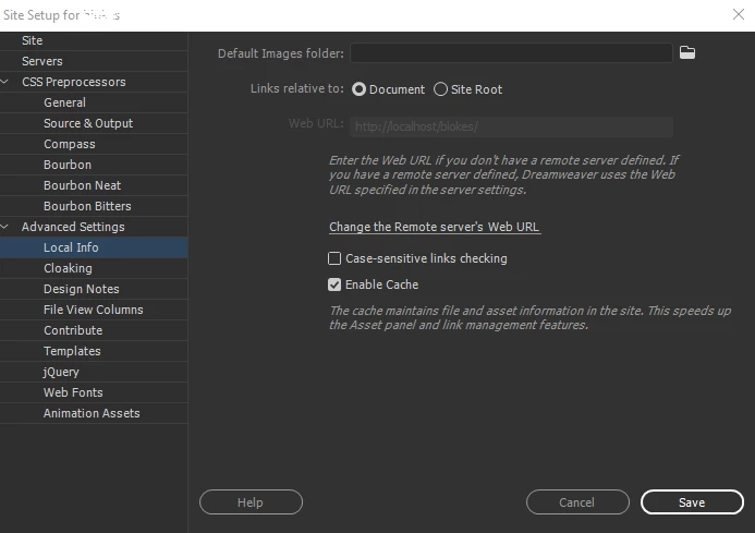

BenPleysier
Jan 18, 2017 5:39 AM UTC
If you have set the new site up as all inclusive, i.e. independent of files in the old site, and the links set to Document relative, then there should be no problem.
Have a look at the Site Setup
