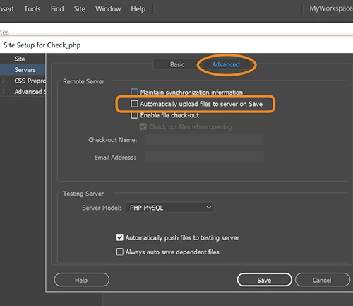

Are you auto uploading files to remote server on SAVE?  You should disable that in your Site settings.  See screenshot.
dyngbyAuthor
May 25, 2019 6:23 AM UTC
Why should it be turned off?
Nancy OShea
May 25, 2019 4:49 PM UTC
IMO auto uploads on save are dangerous.  One mistake could break your whole site.   Test locally first and if everything works as expected, then upload with Ctrl+Shift+U.
