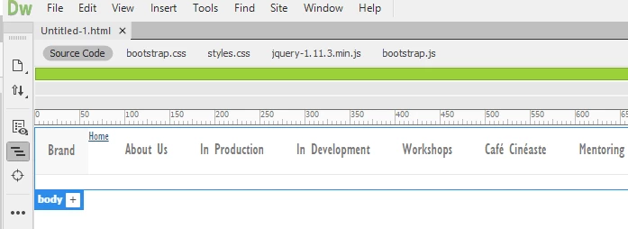

I don't know how I've managed to get my home button like this..
I don't want to build navbar again...any ideas how i can get it back like the other items on the navbar??
Thanks!

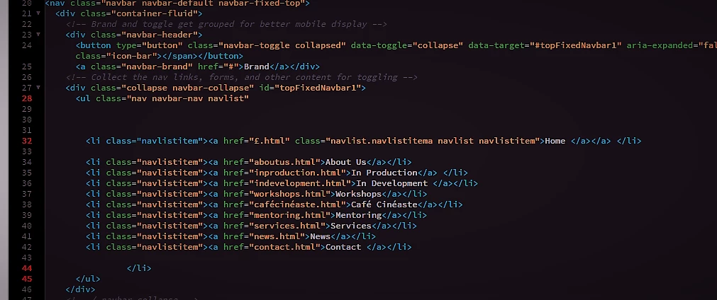

    Just copy one of the good navigation <li></li> from the code and replace the bad one with the good one then change the link to 'Home'
    Just looking at the code you have duplicate <a> tags and classes - you could amend that quite easily but copying and pasting a good line of coding is going to be easier for you.

    Fix your coding errors.
    Your opening ul is not closed, you have 2 closing a tags for the first li.
    Then run the rest of your page through the validator.
