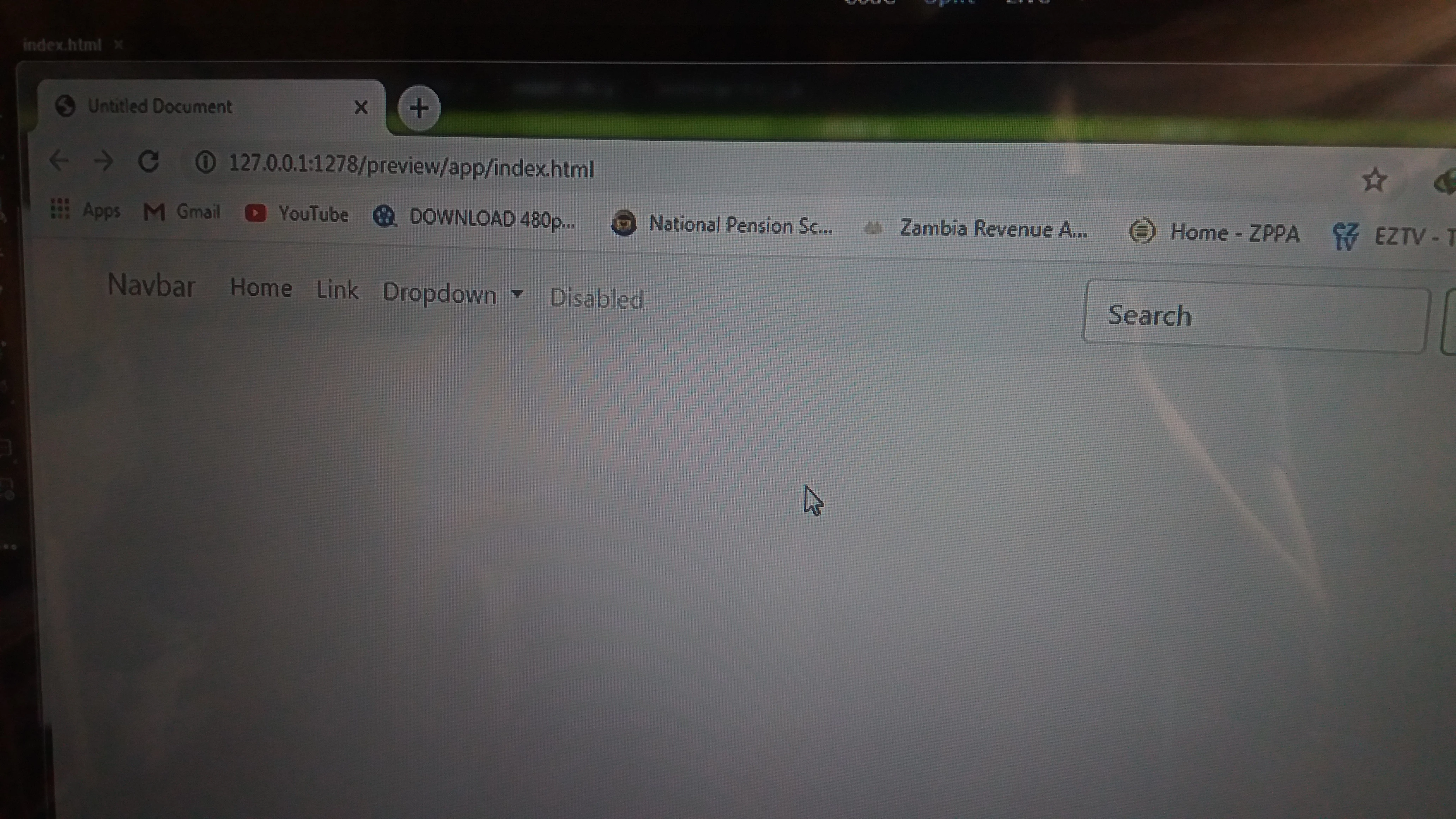

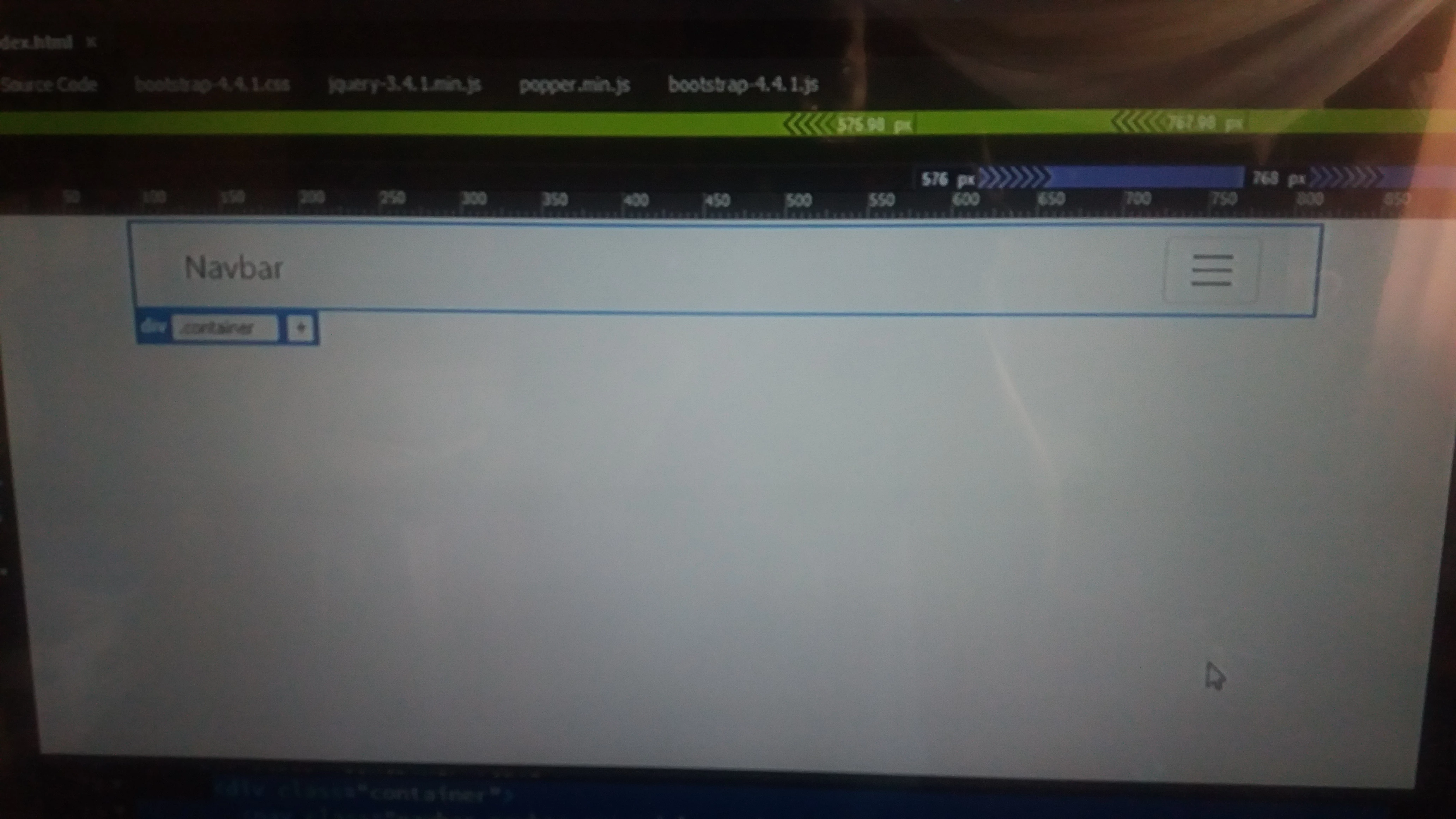

I need some help at the point of inserting the navbar, after inserting the navbar only navbar can be seen in dreamweaver but when I preview the site I can see the other element i.e home, link, dropdown disable and the search that are not showing in dw, what is the solution?

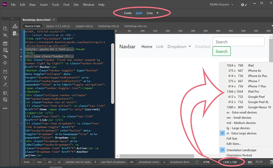

    Hi @Chibwe5FCA,
    See screenshot.  In DW Live view, use Ctrl + Click to expand the hamburger menu.  Or switch to Design view (Ctrl + Shift + F11). Or change the screen properties to something wider.
    Hope that helps.

    Hi @Chibwe5FCA,
    Hope that helps.
    May 20, 2021 6:10 AM UTC
    Thank you so much, I tried the design view which was helpful then I changed the resolution to 1024x768 and it worked like a cham

    Could it be the style changes with whatever the window size is?  Resize the browser window? Does it become visible at a smaller window size?
    AmySykes
    May 19, 2021 8:39 PM UTC
    If so then you know it is just the CSS media queries that need to be addressed.

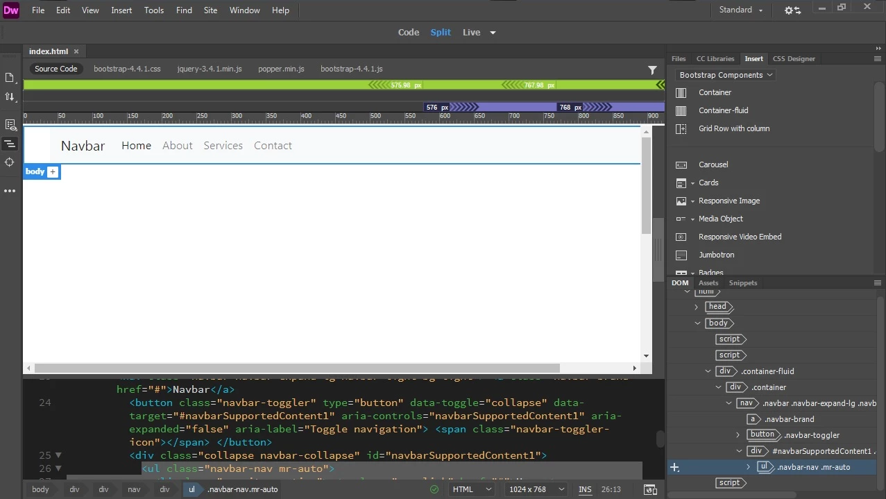

    The upper image shows the navbar in mobile view, the lower image shows the same navbar for larger screens.
    Have alook at https://www.youtube.com/watch?v=h0FwR5F4o5E
