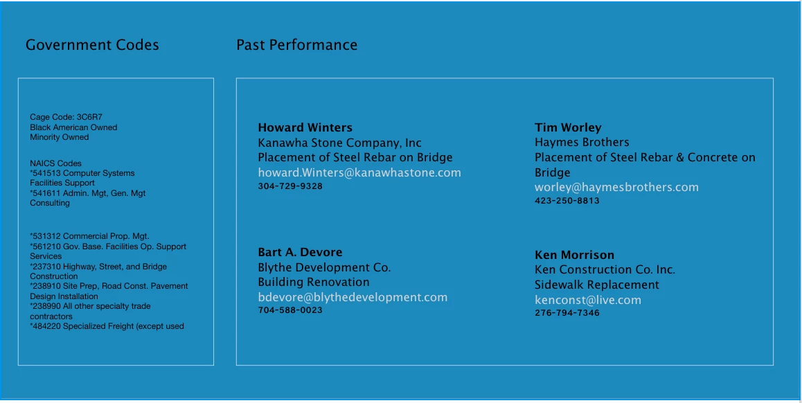

Need help with coding a parent tag, and design issues
In the code I have a section with a class called “refferences”. In this section it holds government codes that contractors use, and past performances for the company I am building the site for. I am wanting both ‘Government Codes’, and ‘Past Performance’ to be side by side like they are in the initial design of the website.
However, depending on the size of the browser you are viewing this on, the both <aside> elements are directly on point, spread out far from each other, or overlapping each other by the ‘Past Performance” below the ‘Government Codes’ out of the blue background of the section.
Another issue regarding the Past Performance class, I coded the whole section in an <aside> elements with the class of “asideRight”, I then put the <h3> element its own style to match up with the past performance like it is in the initial design.
Each past performance company follows in the initial <p> element with the class of “pastCompanies”. I then grouped each company by itself with a <b> element with their own id’s. I did this so I can group each company just like it is in the initial design of the website. Two columns, and two rows perfectly spaced.
However, the companies are not matching up like the design is, even after I go into the css to put a float element or clear element.
For this post, I have removed any css from the companies.

    My apologies, I left out the picture of that sections design in the initial posting. Here it is

    Nancy OShea
    Dec 18, 2017 5:28 PM UTC
    I have no idea what the design is supposed to look like so I can't make suggestions until that's clarified.
    ikevin12
    ikevin12Author
    Dec 18, 2017 9:32 PM UTC
    Nancy OShea
    Dec 18, 2017 9:44 PM UTC
    Ok that's what you envision for desktops.  But what about mobile and tablets?
    Do you want to break to a single column with Performance beneath Gov't?
    Are you using Bootstrap layouts and if so, which version?
    Nancy
