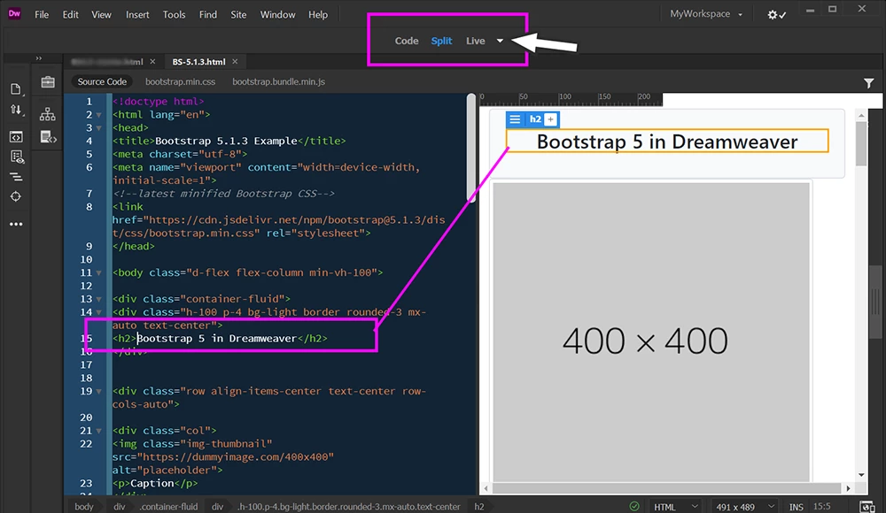

    Use Ctrl/Cmd + Shift + F11 to toggle between LIVE | DESIGN view. Or use the Document Toolbar that @Jon Fritz mentioned.  See screenshot.
    To edit in LIVE view, double click until you see a gold border and then begin typing.
    Or edit within the CODE panel.
    Or switch to DESIGN view.  Your choice.

    All of that being said, Design View has not been replaced in the latest version of DW, it's still there.
    1. Go to Window > Toolbars > place a check by Document
    2. In the Document Toolbar, you'll see a small triangle next to Live, click it and choose Design
    That will turn on Design View, which should be nearly identical to the one you used in the past. The Live View Editor was meant to replace it, but Adobe never got that far before putting DW on life support.
